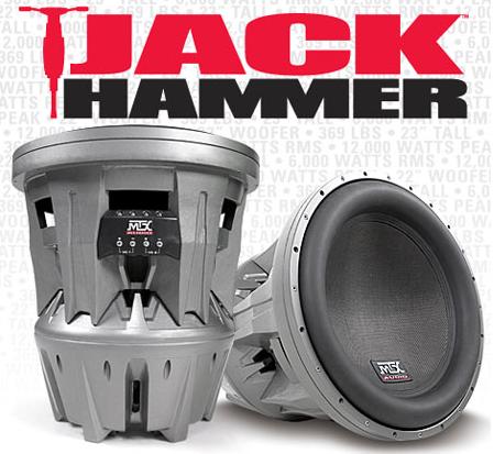

The Jackhammer is a 22" subwoofer rated at 6.000W RMS. It weighs 369 pounds.
There is a funny video where some guys are trying to install one in a car.
Whoa. That's insane.
In a car? Wouldn't you need a dedicated generator just to power it?

As for that MTX Jackhammer woofer, I wonder why the designers went with aluminum voice coil instead of copper? Copper has always been the staple of truly high-quality voice coils.

AT 369lbs. who cares about a few extra ounces between copper vs. aluminum?? Copper makes for better heat transfer than aluminum also.
@HiTech
I am not much into loud audio, but figured a lighter coil might allow the cone to accelerate better.
Here is a relevant patent:
http://www.freepatentsonline.com/3935402.html
Here is a quote from a speaker manufacturer that supports use of aluminum. Apparently it is used of 3 reasons:
1) Increased current capacity and heat dissipation
2) Anodized aluminum can get hotter than enameled copper without hurting the insulation
3) Low mass
Considering their size, the W7 voice coils are extremely light in weight. We use aluminum-alloy wire (instead of conventional copper) and a specific winding method to achieve the electrical properties that we deemed necessary to achieve our design goals. The light weight of the coils helps keep the overall moving mass down at manageable levels, which is extremely important for efficiency and sound quality reasons.
John
