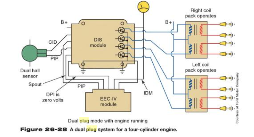

I am wondering for an engine that has two spark plugs per cylinder, and I wanted to fire two individual coils at the same time, which method would provide the most spark. Wire the coils in parallel or in series?
Thanks for any replies.
Breakdown voltage rises in series and under 8:1 compression, so parallel

With two plugs in parallel with different Breakdown Voltages, they need separate magnetos's or coils as the arc is a like an SCR with a negative resistance.
So if the Arc voltage is sufficiently high, from one coil only, series makes more sense to share current. It's not about the fastest or synchronous spark that gives power.
From what I have read and understand better now, is that there are several different designs of twin plugs. This is my understanding.
For more reliability, twin combustion plugs must have twin ignition coils but are triggered at the same time. Sometimes one for starting and two for running or manually controlled.
For lower emissions, twin plugs in different cylinders of different thermal sizes are in series using a single coil with the plug tips in series. Thus one conducts from body to tip and the other from tip to body. One is for the exhaust stroke of unspent fuel on an opposite cylinder while the other fires during compression stroke.
For more power or combustion efficiency twin plugs in the same cyl. using a differential coil with series connected plugs Note that when in series, one plug arcs from tip to ground, while the other arcs from ground to tip. But they can no longer be both centered in the cylinder, so I suspect equidistant.
