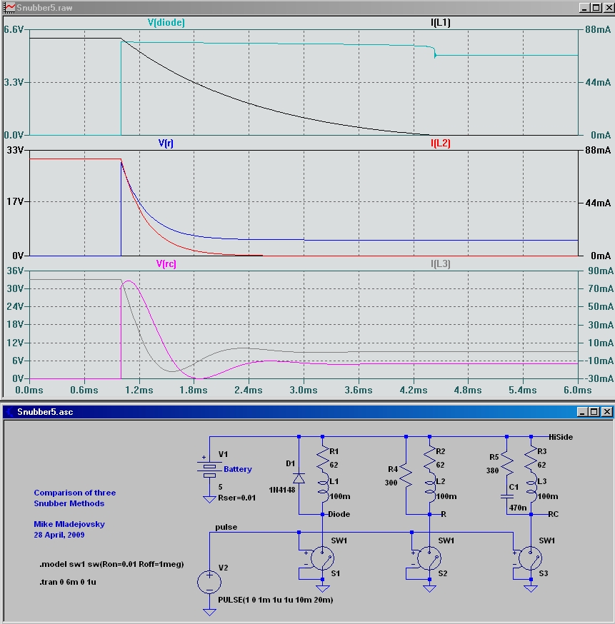

Here is a comparison of three different Snubbers. Note the relative release time of the three methods (current through the respective coils). The RC method is the fastest release, and doesn't add to the current when the relay is pulled in like the resistor only does. The magnitude of R4 & R5 determine the voltage overshoot, which must be kept within the breakdown voltage of the switch (transistor, fet). Higher values of R4 & R5 shorten the release time at the expense of even higher peak voltages.

You didn't model the diode + zener I mentioned they use in high end devices to achieve fastest release times?
With the zener as high as possible, say 36v zener when using most 45Vce small switching transistors.

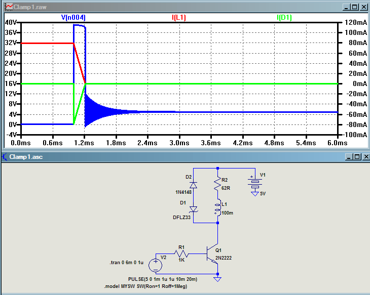

This is with a 33VZ ans 1N4148 clamp.:)
Its a fast release, used on 'old' paper tape punch pin solenoid drivers.

This is with a 33VZ ans 1N4148 clamp.:)...
Interesting ringing that happens after the voltage drops below Vz. Coil inductance vs Zener capacitance? Wont effect the relay, but might cause EMI.
I also noticed that when using R/C subbers, thought it may be an artefact from Spice.
I avoid using the zener/diode clamp when logic circuits are close by, the 30V 'spike' can radiate a fair distance.
I have only used this combination, when clamping solenoids, its too noisy.
Perhaps you recall the old style paper tape punches, if the punch pin retracted too slowly you got a tape tear/jam.
I also noticed that when using R/C subbers, thought it may be an artefact from Spice...
I had to play with the R and C values to get the highly damped waveform in the Spice sim I posted yesterday. The Ratio of R to coil resistance sets the peak value. Higher values of R increase damping. C sets the slew rate and smaller C reduces damping. To optimize R & C in a practical circuit, you would have to know coil inductance and resistance.
A diode can also be placed in series with a resistor to avoid the wasted power in the resistor, yet still largely improve contact release time over a diode alone across the coil.
The peak flyback voltage will be the resistor value multiplied by the relay coil operating current. The larger the resistor, the better.
Plus the supply voltage.
Cool, thanks!
Re the ringing, in actual use the circuit performs better than the simulation. Relays have massive iron losses, as the stator is a pressed mild-steel bit of garbage generally, not a proper magnetic core material like a simulated inductor.
So in real life the huge iron losses act like a big damping factor on the flyback energy (which should be less/faster than you show in the sim) and also damp the ringing which i have never seen on the cro.
