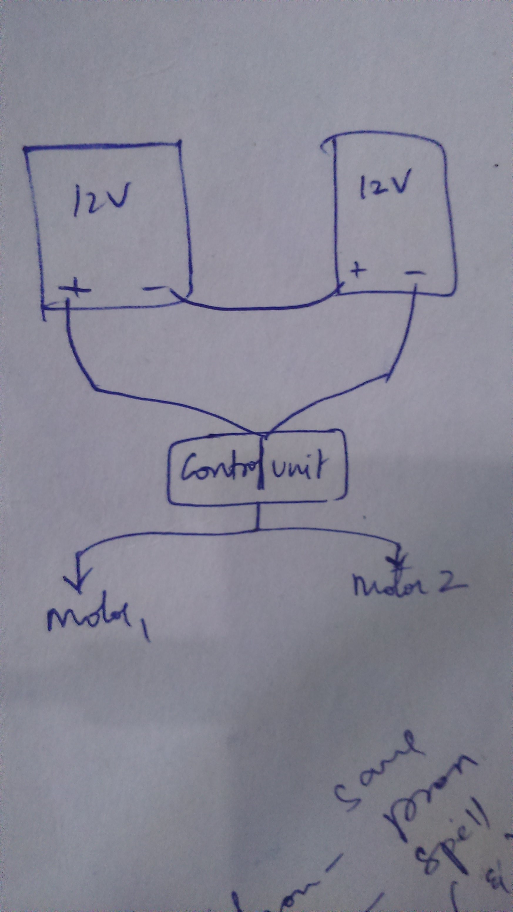

This way am planing to connect my batteries and motors
What rating of battery is suitable
And better way to control these motors each of capacity 180v dc, o.5 HP
You have now changed your requirements from the original post. You now have two motors when you said there was only one so you noe need twice the power which will be twice the current.

Batteries are capable for 500 w, 20 A
What is the real specification of the batteries?
If you mean that they are 20 AmpHour batteries, then they won't deliver 20 amps for very long. And the Voltage will likely drop below 12V within the first few minutes, which means that the current drawn from the batteries will increase.
It's nearly impossible to tell you how to control the motors, unless we know what you want the motors to do.

1 HP = 746 watts but to alow for losses I think the calculations should be based on 1KW 1KW at 24 volts is 42 amps so theoretically you need a 21 AH battery. The AH rating of most batteries is based on discharging them over about 10 hours. The AH rating is very much reduced when they are discharged over such a short period of time so you would have to look carfully at the battery specifications or contact the manufacturer to suggest a suitable battery to support this high discharge rate.

Let's set aside the question of battery for the moment and concentrate on the DC to DC converter specification. And, rather than rely on scattered posts, please compile a single specification for what you need. Let me start with what I know. Please edit and add whatever you need to.
Input: 24VDC
Output: 0 - 180 VDC @ 2.6 Amps
Control method: microcontroller
You said that there were two motors. Does that mean two, 2.6 Amp controllers, or a single 5.2 Amp controller?
In your original post, you also secified no transformer. While not impossible, doing this without a transformer will increase the complexity of the converter. What is your reason for no transformer?
