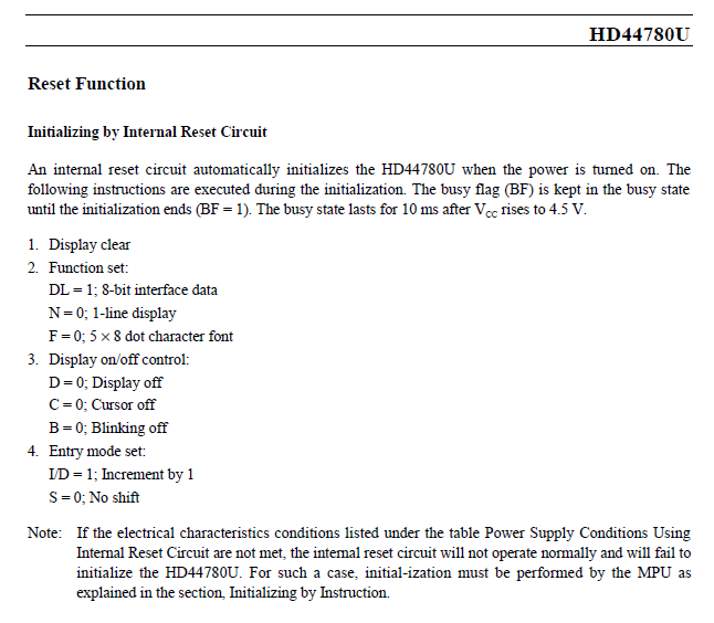

To say that the device starts up in 8 bit mode may be a mistake, because according to the data sheet the first three commands are interpreted as 4 bit commands, not 8 bit, so the 4 upper bits are looked at and the 4 lower bits are ignored.
That's curious. I never saw that in the datasheet. My comments about the controller starting up in 8-bit mode were based on the datasheet description of the power on reset sequence (see attached).
  • HD44780p24.pdf
I didn't see it either. Here is a snippet from the datasheet:
As typical, that comment is not particularly clear to me. Nevertheless, even if the first 3 writes are 4-bit, you still have the fourth write (changing to 4-bit mode) to deal with.
John
I think what they are referring to is that the command that puts it into 4-bit mode, 0010.xxxx, includes additional options in the low nibble which cannot be sent because the x bits are not wired up. So, after sending this command, you have to send it again in 4-bit mode so that you can set the low nibble options. For example you would send 0010.xxxx to select 4-bit mode, and then you would send 0010.1000 again to select 4-bit mode plus the 'two line' display option.
BobW, Yes agreed.
I was responding to the assertion that the first three commands were considered 4-bit commands, not 8-bit for which the lower nibble didn't matter. I do not have an 8-bit interface up and running. Maybe tomorrow, I will test an 8-bit interface by sending 0x3c or ox3F for the first three commands.
John

I mentioned that calling the start up mode "8 bit" may not be the best idea because the LCD only sees 4 bits anyway.
My analysis suggests the display comes up in 8-bit mode automatically after its power-up reset. The Datasheet shows you can send a "function set" instruction immediately after the self reset that includes data in the lower (bit 3 & bit 2) data bits.
... another trick is to use only 7 bits keeping the most significant bit low (or high as needed).
Wouldn't that prevent you from sending "set DDRAM address" commands which require bit 7 (D7) = 1?

Do you mean that you found that you do not have to send the start up sequence for 8 bit mode too then, only for 4 bit mode?
No, that's not what I said. Please re-read the post.
If you have evidence to the contrary please supply that information.
If you mean evidence that the HD44780U comes up in 8-bit interface mode after power-up reset, I would refer you to this section of the Hitachi HD44780U (LCD-II) Datasheet.
Thanks for posting that, but you seem to be missing the point. What i am talking about here is realism.
One of the definitions of realism is and i quote:
"The attitude or practice of accepting a situation as it is and being prepared to deal with it accordingly."
Let me emphasize the phrase, "as it is". This is in stark contrast to, "as it was written".
Although the data sheet *was written" stating that the LCD comes up in "8 bit mode", that's not how it really works, even if we interpret the data sheet literally later on because it states that we are to send it codes that only utilize 4 out of 8 bits before we can start using it for ANYTHING.
That's why i asked for proof to the contrary, because there might be some shortcut since one of the bits is set that indicates 8 bit mode. But just because the bit is set that also does not mean it is really in 8 bit mode because again we have to send it data that only utilizes 4 bits.
Im sure you know the difference between 4 bits and 8 bits.
Proof to the contrary would NOT come from the data sheet in that form alone. It would come from an experiment to find out if we can skip some startup code listed on the data sheet that allows us to use it in 8 bit mode without having to send 4 bit codes. That might be a benefit for people that want to use it in 8 bit mode, if it is even possible. The data sheet suggests otherwise however, that we must send a series of 4 bit codes to get it up and running and switched into ANY MODE. So it sounds like we cant even use it until we send a series of FOUR BIT codes, and that suggests that it really comes up in a FOUR BIT initialization mode not 8 bit. If it came up in 8 bit mode, we'd have to send it 8 bit codes right away.
I made this as clear as it possibly can be.
