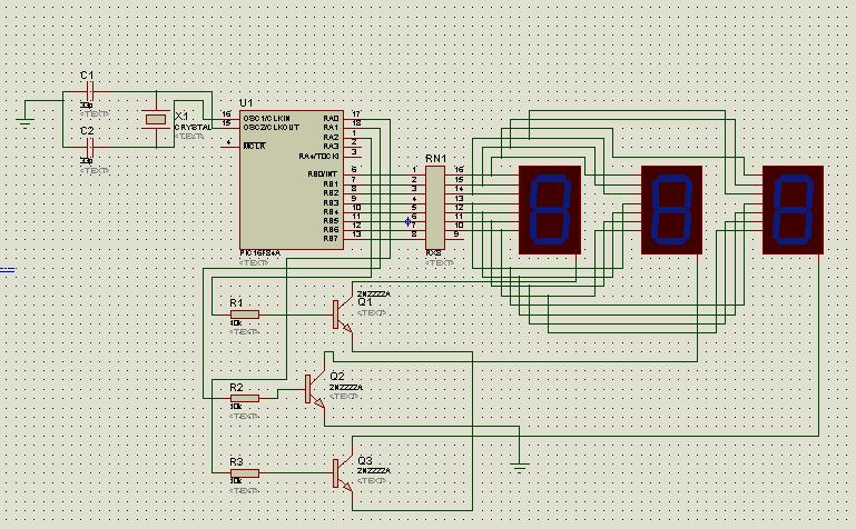

If you multiplex the displays you can run up to 4x 7-segment displays from a single 16F84 -
The MCLR pullup resistor and the oscillator circuit were omitted from the schematic for the sake of clarity.
To display decimal numbers 1, 2, 3, and 4, the code would look something like this -

You'll notice in the schematic that RA 0-3 control the ground source to each display unit via the 4 transistors. In the code, you write the appropriate hex value that lights up the required segments for each digit to Port B. Then you set the RA bit that turns the grounding transistor for the display you want to activate on, run a delay loop, then immediately turn it off by clearing the appropriate RA bit.
You then write the next hex value to Port B, then set the appropriate RA bit to turn the next display on, then off again...so on and so forth down the line.
You want to clear the RA bit that controls the previous digit prior to writing the required hex value for the digit to be displayed for the next display unit to Port B.
In reality, you're writing the hex value that is required to light up the appropriate segments for the digit to be displayed, turning the display on, then off again sequentially for each display unit. The catch here is that the uC does this all too fast for the human eye to actually see the numbers turning on and off. Thus to the human eye it will appear that all of the digits are constantly on but are different decimal values.
With longer delay loops you can do scrolling digits as well.

next is on jon's scematic and code to drive the 7-seg displays. i simulated his schematic using proteus but haven't seen yet the results, since the code for look-up table is still in the process. i need the look-up table to set correctly the PORTB pins. i'm confident however that what he suggested is the best solution so far i can tell. thank you very much jon i am making a look-up table to properly light up the correct leds. it's your idea also to use the sublw instruction, thank you again. i will look closely how you coded yours and try to learn from it.

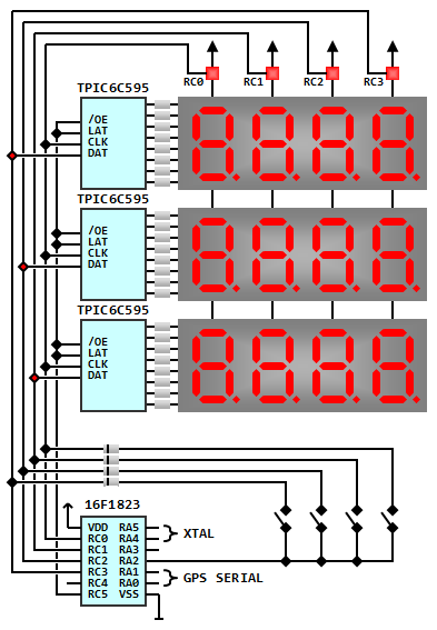

... With some complex multiplexing and the addition of a couple of BCD to 7 segment LED drivers, you can drive 8 7 segment displays with a single 16F84 ...
Hi Jon,
Just wanted to supplement your fine example.
If the design allows for adding driver ICs, you can actually drive a lot more than just eight 7-segment displays on the 'F84. For example, you could use 5 pins to drive 12 displays (3x4, see below), or 6 I/O pins to drive 20 displays (4x5), or 7 I/O pins to drive 30 displays (5x6), and so on. And if the 16F84 had a PWM module you could take advantage of complete fade-to-black PWM brightness control running as a 0% overhead background task.
Happy Holidays everyone. Mike
For the first design where the PIC decodes hex values into a decimal value on the readout, this lookup table will do the trick -

For the 2nd design with the BCD to 7 segment decoders, you would write hex values 0x00 - 0x09 to Port B since they have an internal decoder to interpret binary 0-9 into the appropriate number on the readout.
Hi Mike. Coming from you that means a lot as I just got into digital electronics, PIC microcontrollers and Microchip assembly programming about 4 months ago. I've been an electronics guru for almost 20 years but it's all been in the world of analog and valve audio amplifiers.
Thanks for that supplement!
