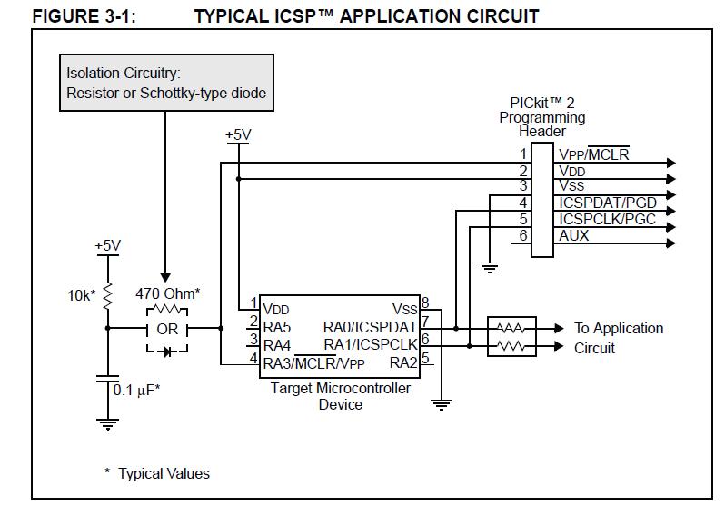

i want to programing this pic now with pickit 2 clone but there is a problem,how can i learn Vdd value 3,3V or 5V?
no i want to say,can i programing with pic kit 2 and how? because i dont understand this pic yet ,pickit2 program give me an error it says no device detected and i think its about Vdd ?
You have it hooked up wrong Take a look at the pictures

maybe i have got a problem with my pickit 2 clone ... imported hex but when i want to write to pic it says no device detected ...?
