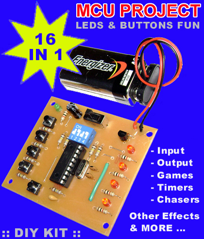

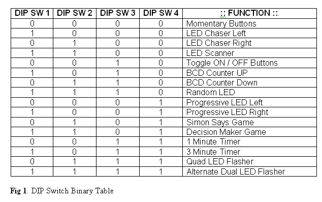

I did this project a while back. It is basically what can be done with just 4 buttons and 4 LEDs?
Q: Anyone have any suggestions to add extra features or improve on things?
img01-jpg.91749
tableleds-buttonsfun-jpg.91752

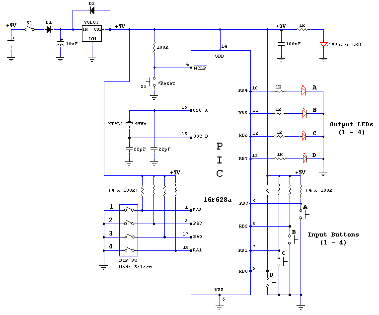

:: Electrical Schematic ::
schematicleds-buttonsfun-jpg.91751

If you want to revise it...
Move LEDs to PORTA and put all the push buttons & DIP switch on PORTB. Set /RBPU to 0 (enable weak pull-ups) and get rid of the eight pull-up resistors.
Omit the crystal and its caps, use the internal 4MHz oscillator.
Diode D2 is unnecessary since you have D1
Lower the reset button's pull-up to ~22K
Options: Use the spare 3 PORTA pins for more LEDs or a buzzer.
Thanks buddy for the feedback & suggestions. I like them ;)
I agree there is no need for D2. Just habit on my part... And it would not work either since D1 prevents D2 from sinking current.
Can you explain to me how to enable weak internal pull-up resistors in mikroC? Also the internal oscillator can you give an example of this too. Much appreciated ;)
Why not the 100K instead 22K for MCLR? I have never had any dramas using 100K. Seems like the higher you go the better right? (less current used) I have gotten away with using 1M ohm pull-up / down resistors for CMOS ICs. No problems whatsoever. The projects all work.
Kind regards,
Trent Jackson
Not a problem for display-less systems.... If I use any more than a 10k the boot time is too long and the LCD display shows uninitialized screen for a small while... It doesn't look good!!
The small reset cap inside the MCLR circuit needs charging to above brownout... 100k just gets there longer!
OK I am convinced. I start and use 10K...
