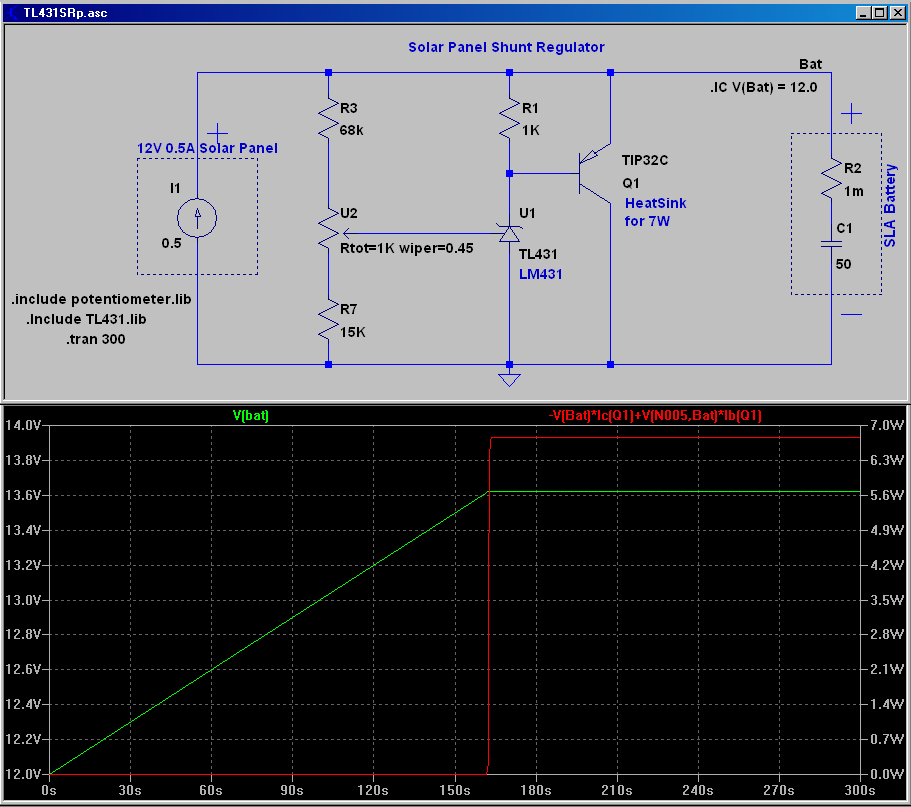

I would suggest two regulators:
The first to regulate charging of the battery. Use a TL431 (fig 21) as a shunt regulator boosted with a PNP transistor.
The second to convert 12V to 6V. Use a 34063

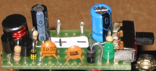

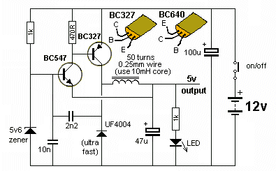

Or you can build your own circuit:
This circuit is a BUCK REGULATOR. It can take the place of a 78L05 3-terminal regulator, but it is more efficient. It produces a constant 5v @ up to 200mA. This can be changed to 6v by using a 6v2 zener.
Roman's circuit is good. Just change the 5.6V Zener to a 6.8V one, and it should work at 6V output. Colin's suggestion in post 16 is likely based on the 34063 chip I referenced in post 14. I have bought those adapters at garage sales for $0.50, opened them up, changed one resistor to set the voltage to something different....
Did you read the 431 data sheet? Fig 21 is simple enough. I can help you adjust it to 13.7V (correct float voltage for a lead-acid battery)

I like Colin's cigarette lighter converter idea, a simple solution. I'll look for one of these first.
Otherwise I'll use the circuit provided or modified with the 6.8V Zener (however the pump also worked well with my 5V power supply.)
For the TL431 (fig 21) circuit: Am I supposed to use the component values in fig. 15 and 16? No values are shown in fig. 21.
Here is the battery charge regulator. With the trim pot set 45% up from the bottom, the voltage across the battery is clamped at 13.62V, which is a good float voltage at ~25deg C. The green trace is the battery voltage; the red trace is the power dissipation (7W) in the PNP power transistor, so it must be bolted to a good size heatsink (an aluminum project box, perhaps)
