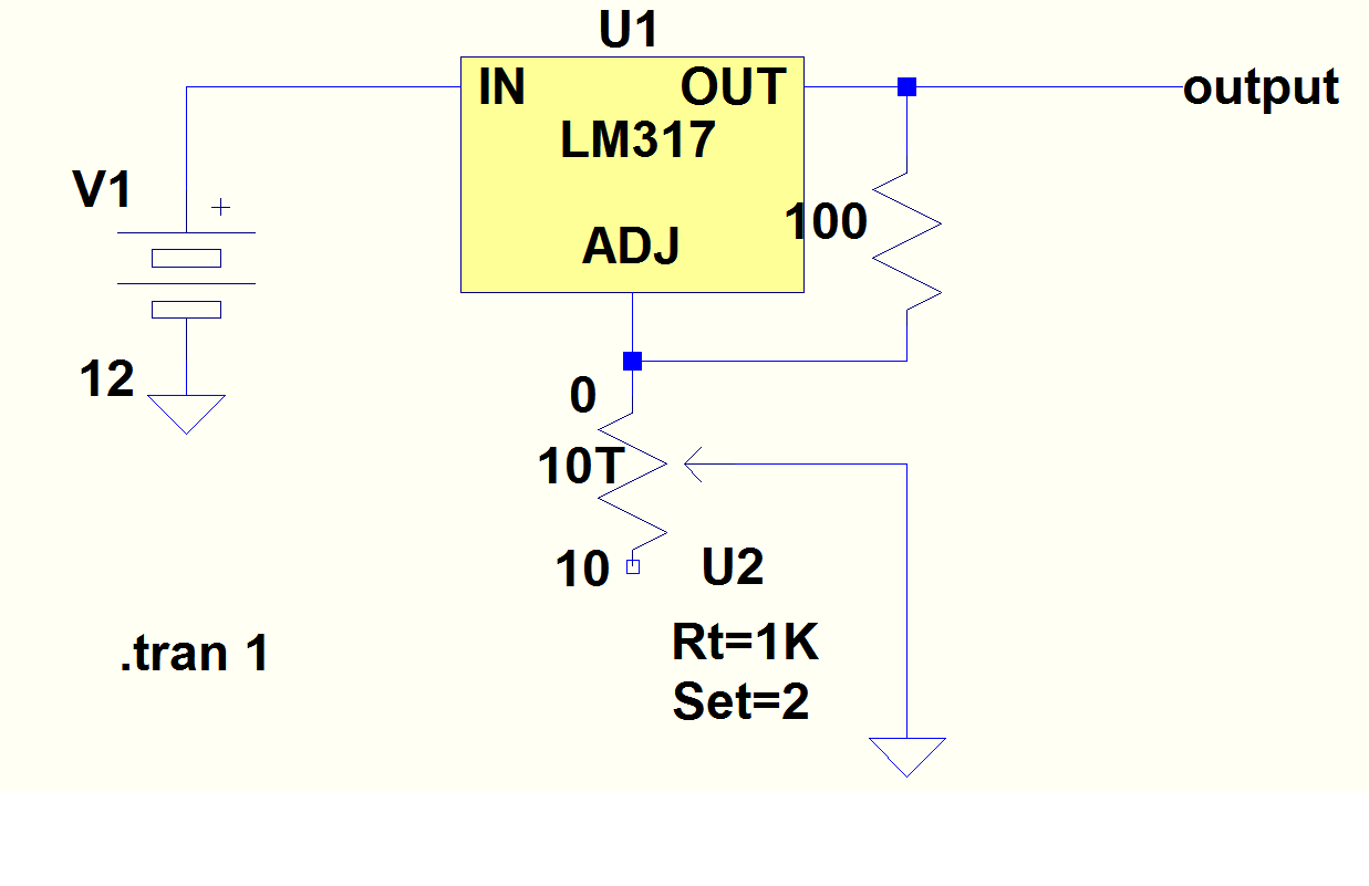

In looking around a bit... I believe "step-down" is the correct term.
12v automotive application. I need an adjustable "???" to step-down between 12v and 9(ish)v. Help?

You can get cheap adjustable switching voltage regulators from ebay.
You do need to know the current rating of the device though, usually stated in mA.
If your current is below 1A, you will probably use what is a type of step-down regulator called a "Linear regulator". You may also find them referred to as an LDO (low-dropout regulator).

You won't need a heatsink if the current is low enough and the input and output voltage are close enough. But you might as well stick a $1 heatsink on it.
You'll have to mount the thing somehow. and solder on leadwires. Probably a small generic proto-board. You'll need one anyways since the regulator requires two resistors (to adjust the voltage) and two capacitors (one on the input and one on the output).
Just search ebay for a LM2596 adjustable module and set it for 9V or 10V. It should cost no more than US$1 incl postage.

My solution would be an adjustable LM317 type linear regulator...
If this thing draws any significant current, more than ~10mA, I sure as hell wouldn't be leaving it connected to the car's battery when engine not running... If it draws only a few mA, then no heatsink is required.

For the OP Untitled.pngtry this if you don't need too much current, use a LM350 though, same thing with higher current rating.
