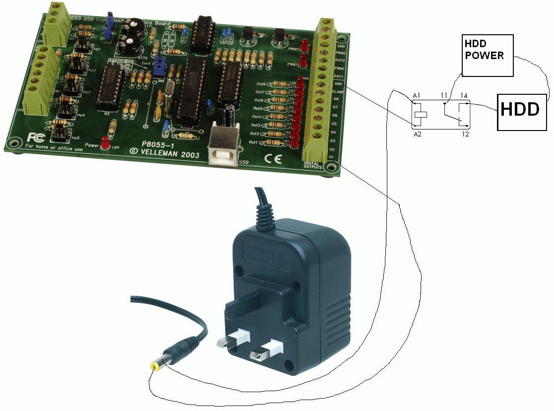

I am trying to build a circuit that will turn on (and off) a 12v 2.0A (max output 24W) device using a 5v control line.
The 5v control is from a USB interface connected to my PC. I have been trying to search for and answer and *think* I may need a 12v Relay (5v control) and perhaps a diode to stop feedback through the 5v line???

You'd want a 5v relay, a 12v one requires 12v at the coil to switch and will not be able to switch with 5v from the USB. You are correct about the diode, use a rectifier (1N4001 etc). You'll need to use on with a low coil current requirement since USB can't supply much safely.
I'd be tempted to use a logic level MOSFET for this. It should be cheaper and silent but the computer and load will need to share a ground to do it.
This should be suitable for a relay, the coil requires 50mA (5v model) which should be permissable providing you don't have too many devices connected:
However, I re-read your post and it sounds like the 5v from the USB is not the power line, but a signal line? If that is the case you will need to use a MOSFET to switch or a transistor/MOSFET to switch the relay since a signal line cannot supply the current for a relay coil directly.
Logic level MOSFET's don't appear to be available from Maplin. Have a look here;
VNP7N04 should do. It'll need to be used as low side switch since it is N-Channel though. What is the device to be switched? Remember, if the grounds need to be isolated you'll need a MOSFET (small one though) AND a relay.

I have an external HD that I use for backups for my work server (12v 2.0A 24W max). At present I have to do this manually, I wanted to be able to turn this device on and off using a USB interface connected to my PC. I would do this through a software app. (I'm a programmer by trade). The USB interface has 5v inputs and outputs. **broken link removed**
Hope this helps
I assume your using one of the "8 digital open collector output switches" for it? It specifies 100ma max, so it can pass the current for the relay. I reckon the neatest way would be to use the USB power line and switch it with the interface output switches. The relay I originally suggested is suitable. Alternatively, you could use a small plug in power supply to power the relay coil.

Ok, for simplicity mabye we'd better go with using a plug in supply for the relay coil. From here:
the
AC/DC UNREG PLUGTOP PSU 12V DC 300MA RC code 85-2913
is fine for 12v relays such as:
32.21 12V DC MINIATURE SPDT 6A RELAY RC code 60-4087
You then use the switch output from that board to switch the current from the plug in supply into the relay coil. This will close it's contacts and, with the external drive connected through them, switch it on.
This shows how to connect up the relay. It is a PCB model and will need to be soldered. If that is an issue, you could use one of these with push on connection:
Anyhow, this shows how to connect up the PCB relay:
I attached a diagram which should help. The only thing i'm not sure on is that board and how it's outputs work, so this may not be everything :( . I'm treating it as a switch, but don't think it's as simple as that.

I've been looking at the manuals for the k8055 USB board, and on page 19 of the assembly manual is a diagram of just what you are looking for. ( Mind you, personally speaking, I'd include a diode in parallel with the relay, as in the diagram you have in your post ). :)
