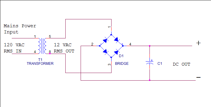

Attached is a basic image of a wall wart power supply. Note that units like this do not afford any regulation at the output. Additionally if we look at the step down transformer it is just a simple ratio device. With an input of 120 VAC RMS the output is 12 VAC RMS or a 10:1 ratio. If the input increases, the output will follow it.
The transformer is coupled directly to a full wave bridge rectifier. The rectifier will have a forward voltage drop of about 1.2 volts for alternate cycles of the AC input, so with 120 VAC in the output of DC will be about 12 - 1.2 = 10.8 VDC.
This is fed to a filter capacitor. That cap unloaded or lightly loaded will charge to about Epk or the peak value of the AC waveform. Epk = Erms times 1.414 so we get:
10.8 * 1.414 = 15.27 or about 15.3 VDC at the output (unloaded).

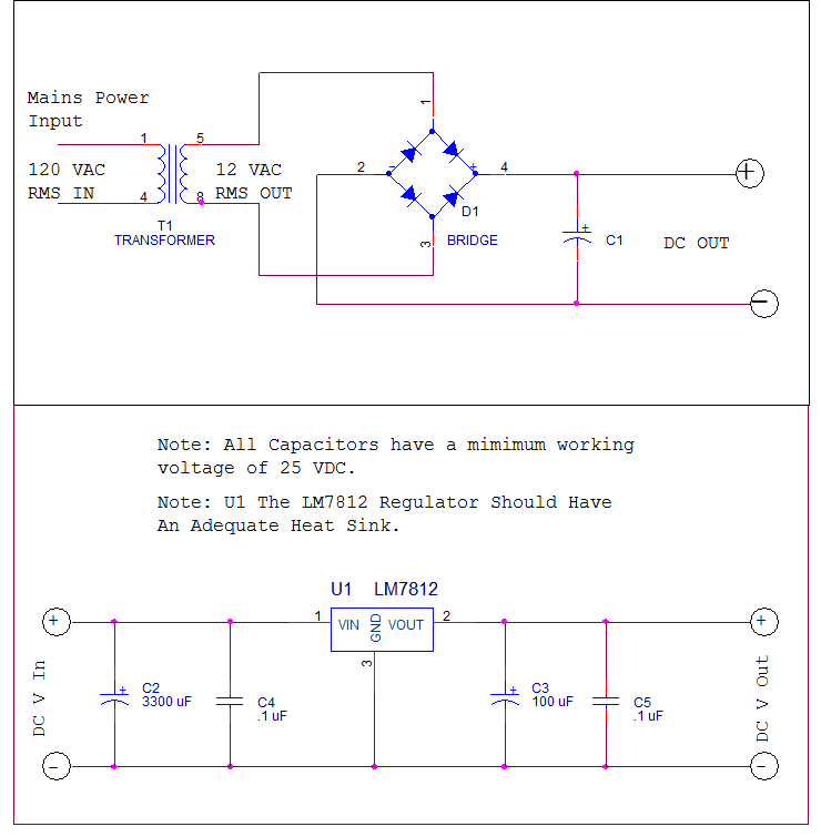

taking this into account i think i need to look into make some voltage regulators that will take upto 20v and give me a smooth 12V to use in my projects
i have bought some 12v 1.5A (7812) voltage regulators but have read into things and it says you need capacitors to get to work. Can anyone explain how and why this works and a rough guide to know which capacitors to use and what type of capactiors as well.

In addition to the sticky post attached is a cartoon continuation of what I posted earlier.
The caps serve to filter and clean up the DC. Additionally they provide reliable operation of the regulator preventing oscillations. There are formulas for calculating their values but a simple rule of thumb is 1 uF per mA at the input side. The smaller .1 uF caps are in there to clean up any higher frequency noise.
The 3300 uF capacitors in my drawing do represent overkill but not knowing what the ripple looks like from the wall wart I went large. Actually 1500 uF would be more than adequate.
Matter of fact the little board I made for PIC projects is few by a 12 volt 1.5 amp wall wart and I used 100 uF in and out as well as .1 uF in and out. It works fine.
Hope that and the link help.
Ron

That is correct and it is called the "dropout Voltage". A 78XX series regulator requires 2 volts above desired output at the input.
There are what is called Low Dropout regulators with less overhead but they are more exception than rule.
