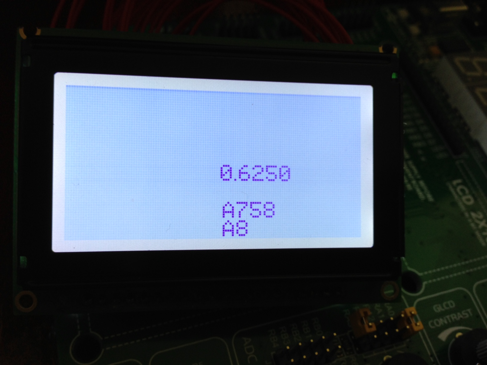

photo.JPGyou mean, there is no need of math.h ? and which float to string function is good (ftoa)?
This is the final main code I am using. This time the problem is with the GLCD update. I can see the PORTA LED's changing according to ADC change but the GLCD got stuck.
I have also attached snap of GLCD.
Thanks Ian..
Carry on with your work.If you get time, please have a look..
Have a nice evening !!!

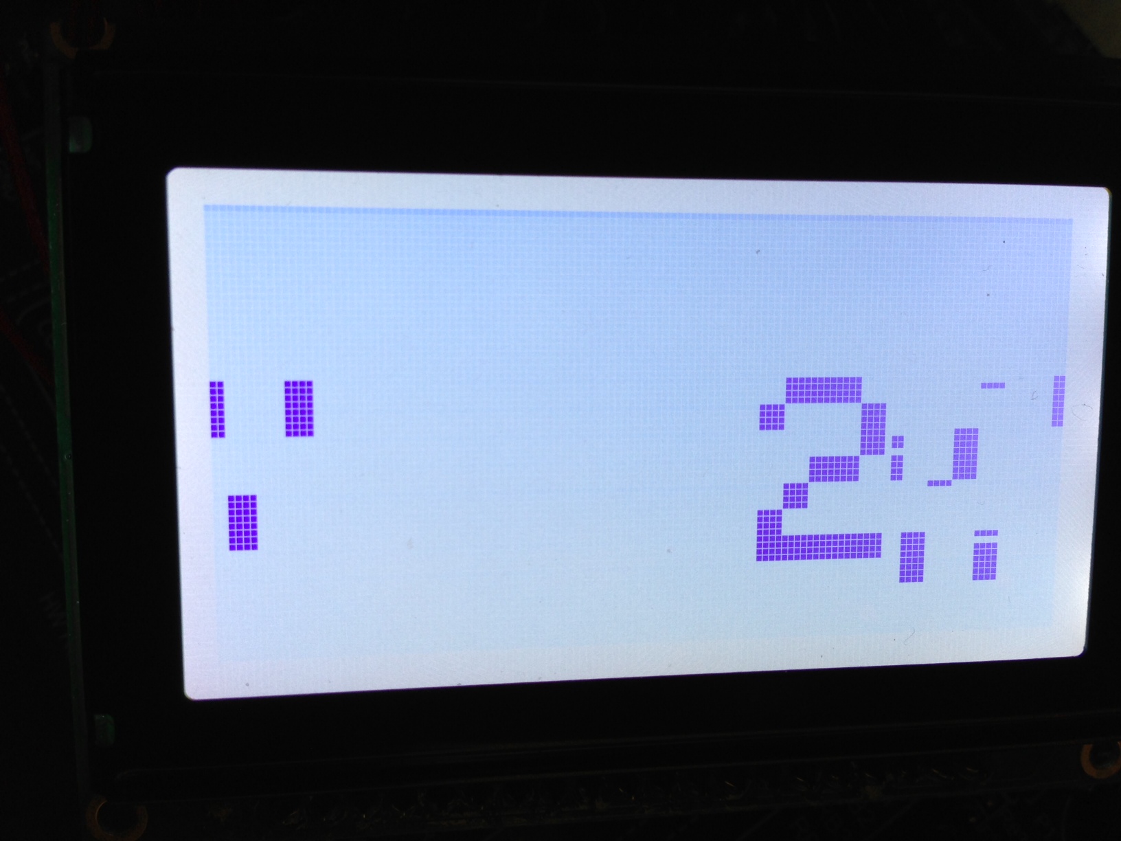

I managed to get working.
Could you please help me with the PutChar32x20 function. I want to print the value with big font. This(PutChar32x20) is able to print the numeric value (with garbage) hoe to modify to display or alphabet and special characters. It would be great if you recommend any website to generate the code for big font.
I have attached the photograph showing the numeric value with noise(garbage).
Cheers

PuChar32x20 function
It looks like you are printing the number too close to the edge of the screen.....
Please can you stop posting in threads all over the place... I just found a posting in another KS0107 thread... I'm going to delete it
Thanks Ian.. and I do apologize for the post.
Could you help me to change my this function to print alphabet please ?
Where can I find the bigger font and what changes need to do ? I have to finish this project by end of march.This is the last task. I need a bigger font.
