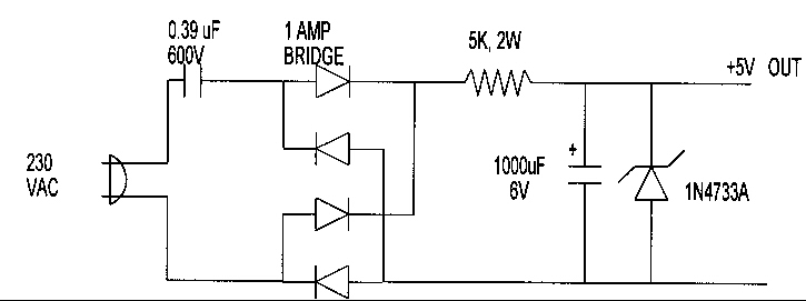

anyone know a small circuit that can detect 120 or 240vac. i want to detect the voltage, and when its on and off, do specific events.
TIA
This circuit will both detect the presence of AC and power the circuit up to 20mA. Note that it is not isolated, don't allow it to come in personal contact!
