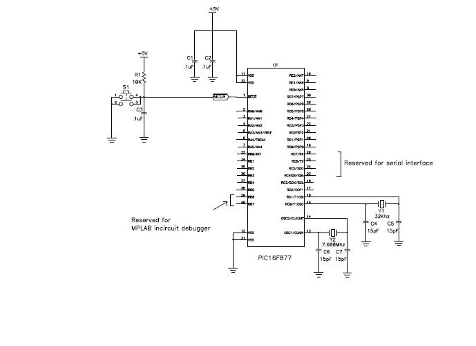

Hey. Here is my code. Please let me know if this code is right. I have decided to use a 12Mhz crystal instead of the 7.805Mhz.
Just to recap:
I want to generate a 120Khz square wave that will last for 1ms (done by gating the RC2 pin) on RC2 when a switch connected to portD.5 is pressed.
Using the formulaes:
PWM period= [((PR2)+1)*4*Tosc*TMR2 prescalar value] and
PWM duty cycle = (CCPR1L:CCP1CON<5:4>)*Tosc*TMR2 prescalar value,
I decided to use the prescale value =1, this then gave me the following values:
PR2= 24 (0b00011000)
CCPR1L:CCP1CON<5:4> = 50 (0b0000110010)-{10 bit value}
Since CCP1CON<5:4> is the 2 LSb value = "10"--> CCP1CON="0b00101100"
therefore: CCPR1L=8 Msb="0b00001100"

Please take a look at my code and let me know if its accurate and correct. Thanks a lot:)
Re your PM. I tried the above code in BoostC and it appears to work as intended. There was some problems but I think that might be just compiler differences. However, the line,
set_tris_d(0xff); //setting port d as input
will never get executed.
Because execution always starts at main. I'm surprised the complier doesn't error with that line.
