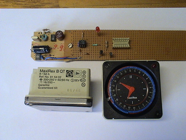

Francesco,
Try to get hold of a quartz controlled analogue timeswitch with battery back up.
This can be a 110 or 230 Volts one.
Those clocks run usually at 1.2 Volts via the back up nicad battery when power fails.
By taking out the voltage drop resistor or capacitor and refit a 1 k.ohm resistor in it's place here.
Then refit the nicad space with a 100µF electrolytic capacitor and red LED in parrallel.
The clock should work then. As added bonus the led will pulse at a 1 second rithm too.
clock
Like this one.
I use one of those in my car succesfully for the last 20 years.
The clock outlived a Ford Falcon for 14 years and is now in a Nissan diesel van.
I use it for timekeeping only but you can switch things on or off if you wish.
Regards
Raymond
Dear Raymond, thank you so much for your email !! Yes I want to do something like you showed me in the picture. I have to switch ON/OFF a volumetric sensor of an allarm security device...just this. I would like to use a power supply of 12 volts, the same voltage of the sensor I have to switch ON/OFF.
Thank you so much again,
Francesco.
