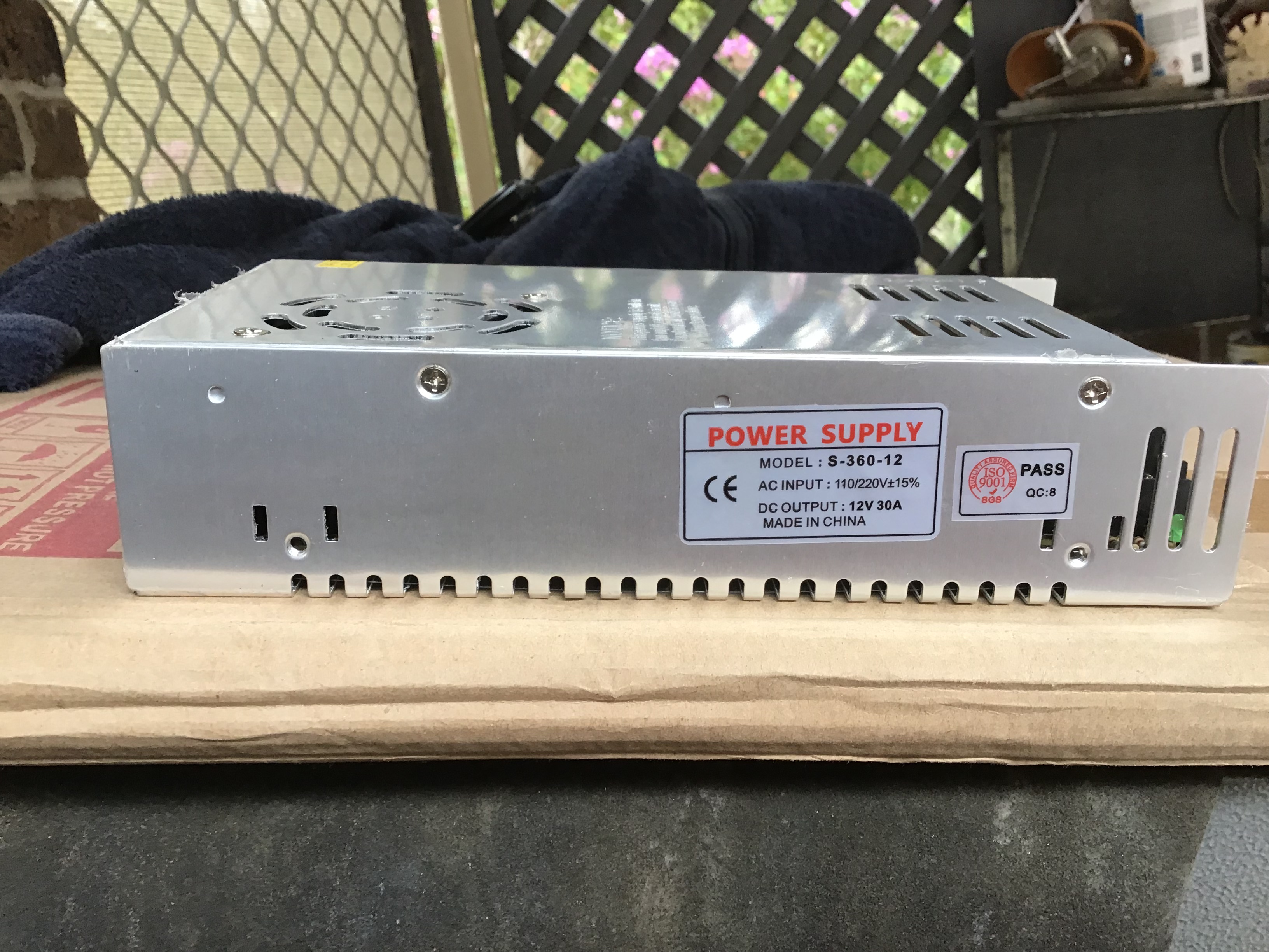

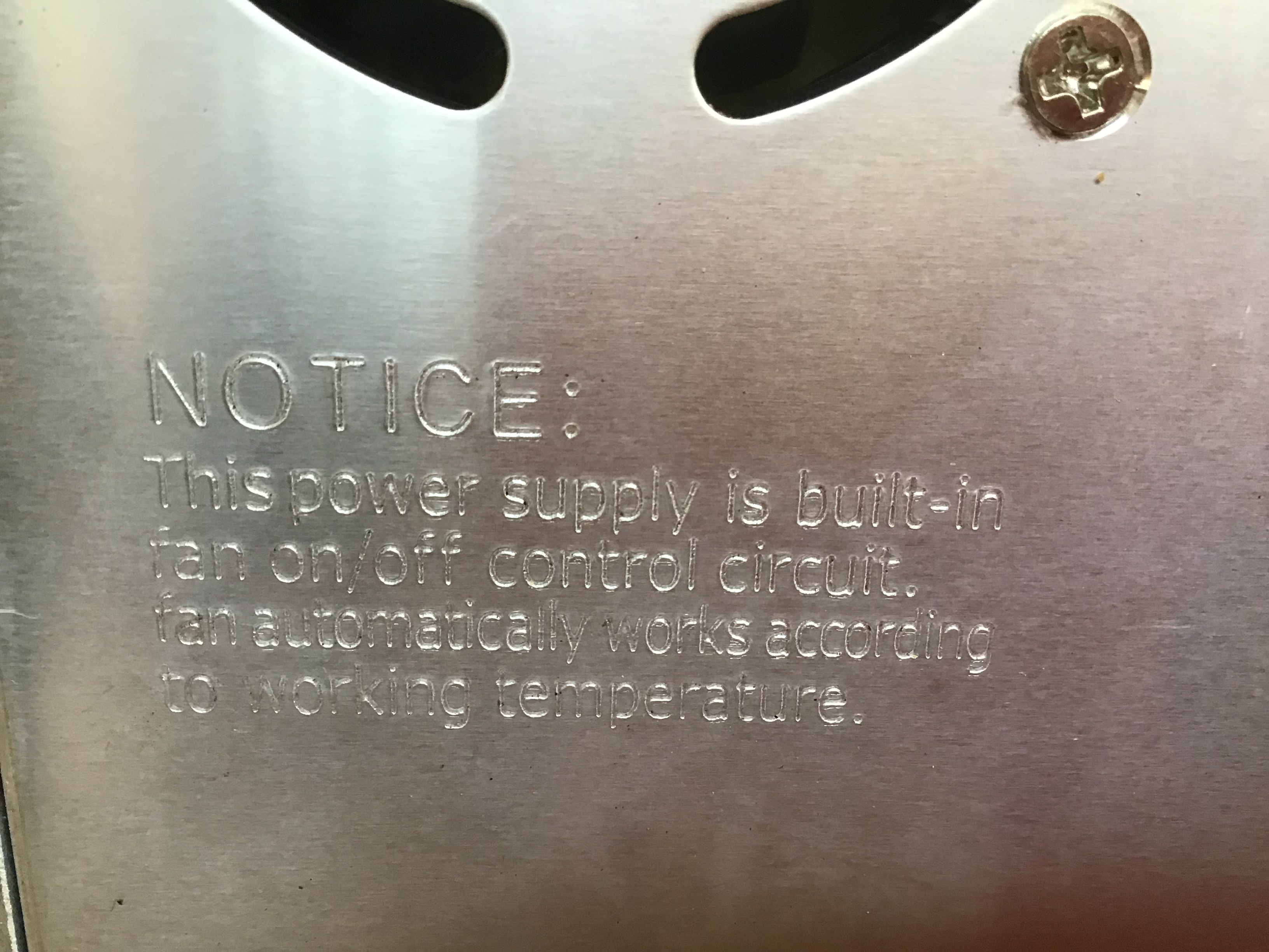

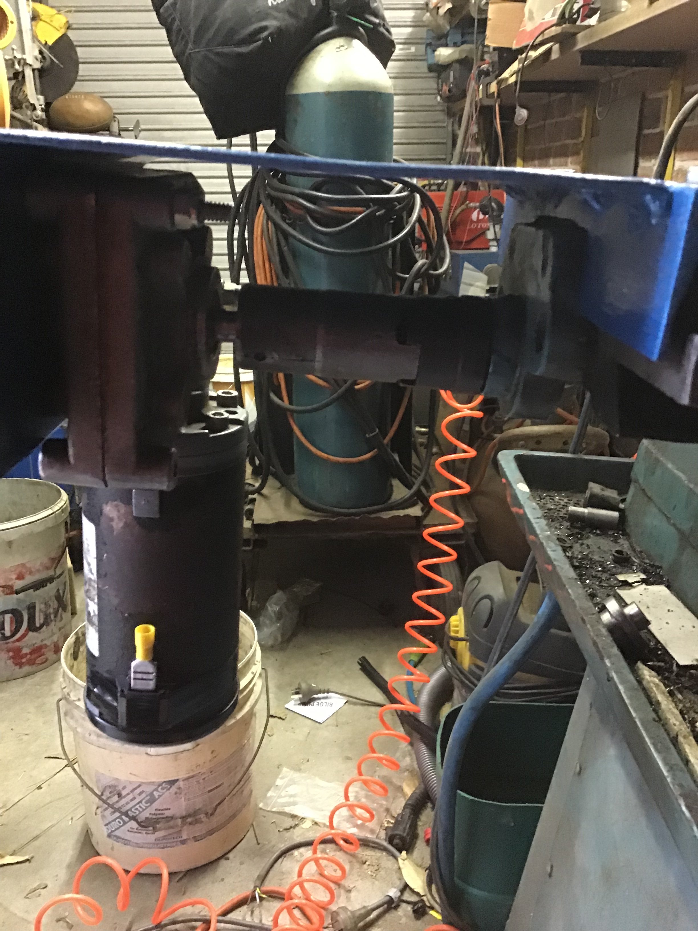

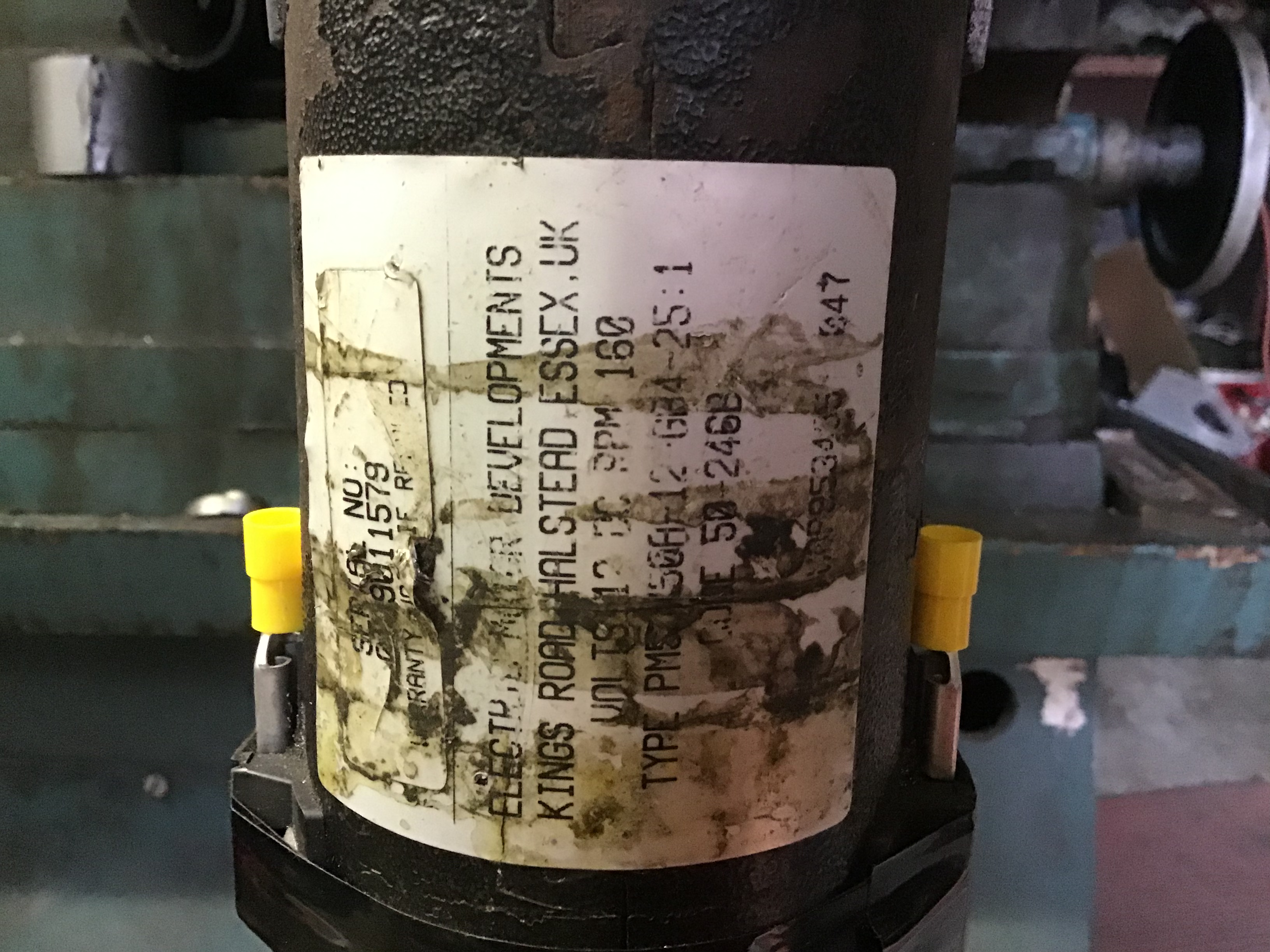

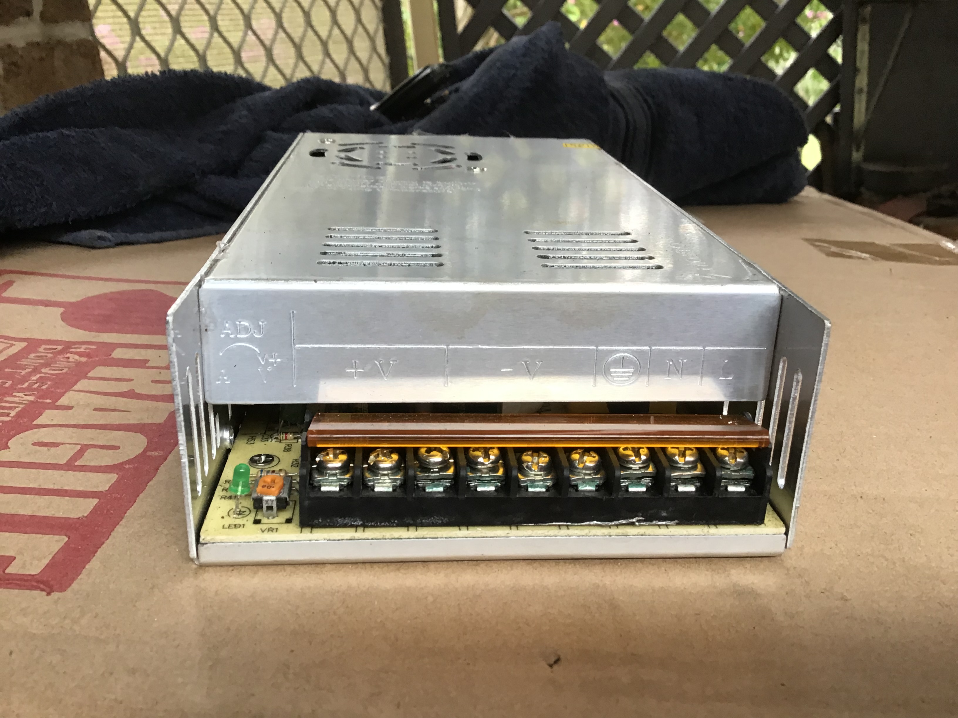

This is the motor and information .
There is no flex coupling as I have made it direct drive from the reduction boxI have supplied a photo of the power supply v 240 ac to 12v Dc The motor maybe 180 w

Short the motor leads and see if it is harder to spin, if so it is a P.M. motor and therfore , no problem.
At 160RPM it must have a gear box?

If spanners etc stick to the motor its permanent magnet.
Coupling looks acceptable.
You need some kind of pwm speed controller, maybe this:
Whatever you go for massivly overate it, stuff these days is under rated.
The motor plate says "TYPE PM5 .......", so I'd guess it's a PM motor.
