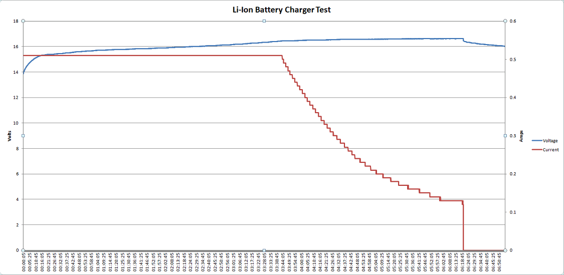

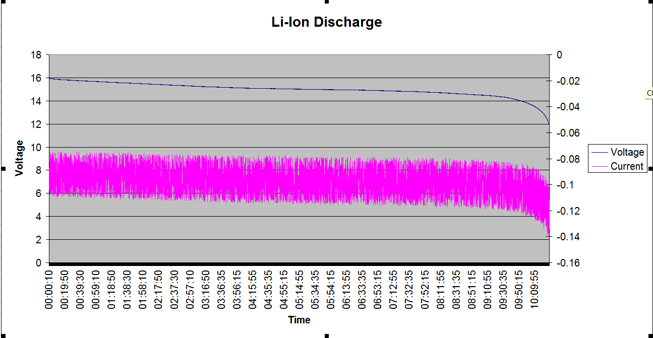

For my 4S Li-Ion based project I monitor voltage and current using an INA219, to 'calibrate' battery life (and charging level) I plotted both current and voltage during charging, and again during discharge - from that I split the readings in ten equal parts. For battery life you only need to monitor the voltage, but for charging you need to monitor battery voltage, and then falling current once it gets to the constant voltage stage. Using the calibration data I display under 10%, 10-20%, 20-30% etc.

I've only got figures here from a charging run, this is for four cells in series, here's the graph:
Wow charging current falls off a cliff doesnt it.
I noticed that internal resistance starts to increase as the cells run out, voltage drops under load.
Looking at the chart theres probably a fairly simple function I could come up with based on volt drop over time.
So far though the best method seems to be measure the volts & amps then calculate energy.

I used an INA219 I2C sensor, and initially a MAX 471 - I was very excited with the MAX471 as the datasheet shows an 8 pin through hole version, which would have been great - then I found out the chip is discontinued, and while you can still find the SM versions from China, through hole versions are more difficult. So I switched to the INA219, which we can buy from RS Components, unfortunately only as SM though.
As for charging LiIon, it's basically down to how fast you want it, and how fully charged you want it - I charge at 0.2C as it gives 100% charge, you can fast charge at 2C but that only gives 80% charge, and I would advise temperature monitoring at high charge rates. I built LM35's in my battery packs (we have a battery spot welder! :D), and have monitored the temperature during charging and discharging, with the result that I decided no temperature control was needed for 0.2C - but the sensor is there (and is already read along with voltage and current) if I ever feel the need to do a software update to do something with it. Currently all the data is 'squirted' out of a serial port for debugging purposes (comma delimited), with a socket on the board where you plug an FDTI lead in. This is where the graphs came from.
