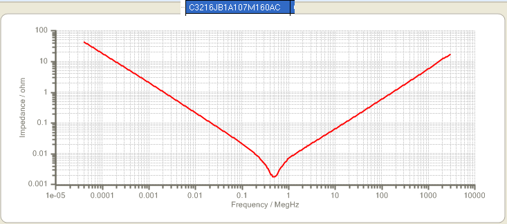

Here is data from TDK: 100uF 25V
This cap resonates at 500khz and probably should not be tested at that frequency.
I have good data from TDK.

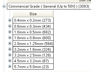

i think 1206 ...3225 metric

The graph you have for the 100uF 25v isn't the same model but I assume it's close. I believe my understanding of SRF and it's importance is clearer, essentially the capacitor has some inductance and acts as a filter, if the frequency is close it passes it through and it's ability to charge will be impaired. I guess it'll cause the capacitor to heat as well.

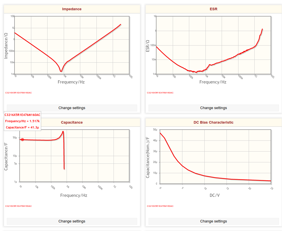

I have 6,000 TDK caps (it would be good to use them up if there's a method!).
C3216X5R1E476M160AC data
Capacitance - frequency is ok.
ESR, ESL - very good at 380khz.
Previously I thought low impedance had to be avoided, but it's still 2Mohm at the lowest point? Wasn't that the issue with the 100uF? Still confused I reckon!
The only thing confusing to me are your priorities and overall measureable objectives. Cost, Qty, performance. Your design is far from complete or ideal,but may work in some conditions.
-low ESR means less loss or to dissipate less heat. (good) but if no current limit elsewhere can conduct more current...which needs attention.
-reactive impedance stores energy or changes impedance with f or Z(f)
-when you operate past SRF, phase of current shifts with voltage 180 deg and closed loop can become unstable, unless shunted with another part to take over.
