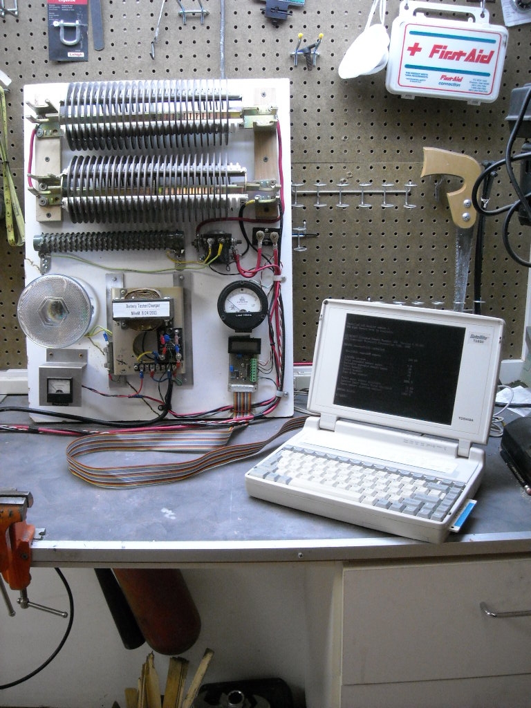

Here is a picture of something that I built years ago. It is a computer-controlled capacity tester for 35Ah lead-acid aircraft batteries. The two big coils on top are "locomotive braking resistors" that I bought from a surplus dealer. They are rated at 1200W each.
I have two of the braking resistors left over from that project. One is 0.069Ω and the other is 0.150Ω., each rated at 1200W in free air. I=24/(0.069+0.150)= 109.6A.
If you can use these, contact me via PM.
