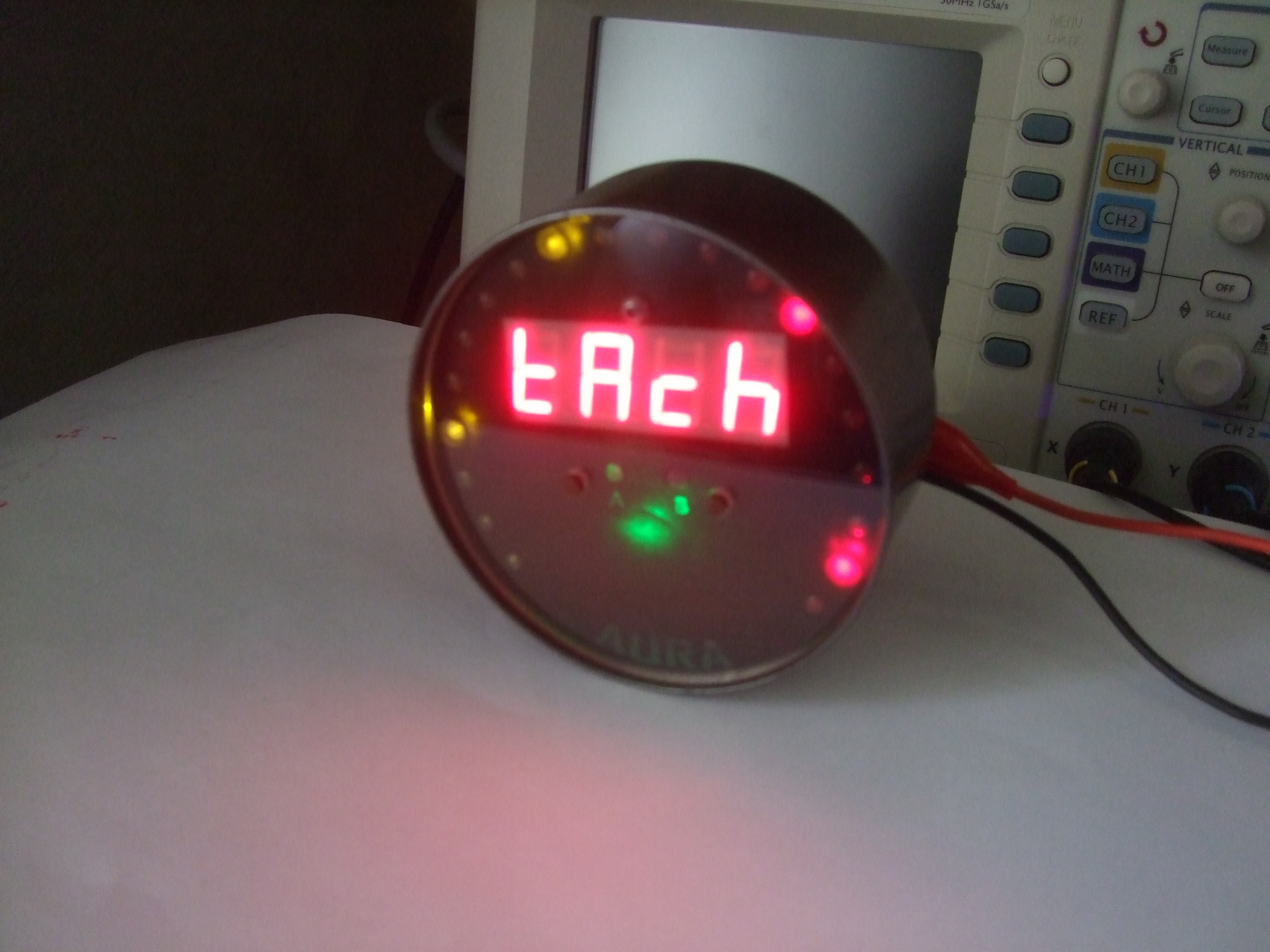

BTW...slightly OT,but here are some pics for a round and rectangular version of the same gauge/controller , a marketing blurb and a user manual that , well, is daunting in the amount of features (18 menu trees) including electronic BOV control for optimum boost retention during gear shifting and reuse.
Damn thing took me over a year to do.

Wow - Very impressive ! I bet it did take a while. You should get set up to make high volumes and start selling these along with the components as a package. Megasquirt users, for starters, would probably jump all over them !!
