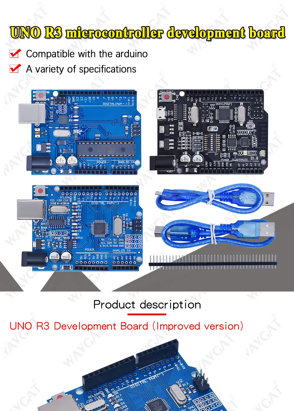

Okay. Here's an example of my confusion.
I follow that link to the arduino platform site; and then the "parts list" link to the arduino uno at Aliepress; then click on the first link there and I see this:
There are 3 separate boards there.
  • Do I get all 3 for "£1.42 - 5.49"?
  • Do I need all 3?
  • Or do I need to pick one of them?

Essentially just the same boards, the first ones used through hole processors (even in a socket) - so the top left picture, next they switched to a SM processor, the bottom left picture. The third version uses SM processor and a USB-C connector. There are also various minor versions with-in each type, but basically they are the same - and either use the same IDE settings, or simply select the exact one in the list if it's listed.
The same applies to numerous compatible boards, but ones with other processors need you to install the relevant compiler - this is well documented, as is everything about the Arduino. Many of the compatible boards are MUCH higher specifications, but essentially run the same programmes with very minor changes.
So just pick one, whichever you like the look of.

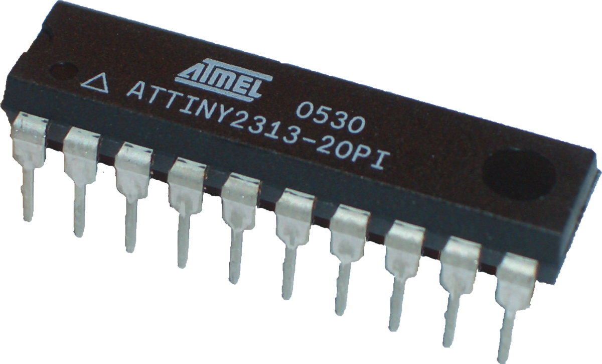

If you get a UNO or Nano you can use it to program ATTINY family (gets you down to 8 pin dip) -
Here is example using to build complex timing sequences (using gui block programming) -
Regards, Dana.

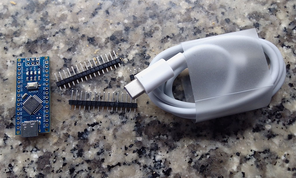

This is the Arduino Nano I bought with USB-C connector.
If you prefer to just use a chip then your project can be developed on the Nano and when you design a board just incorporate the (everywhere) Nano schematic.
If commercial, I too would have concerns about security and would probably go the pic route.
Edit, the Uno and Nano boards are practically identical except for footprint size.

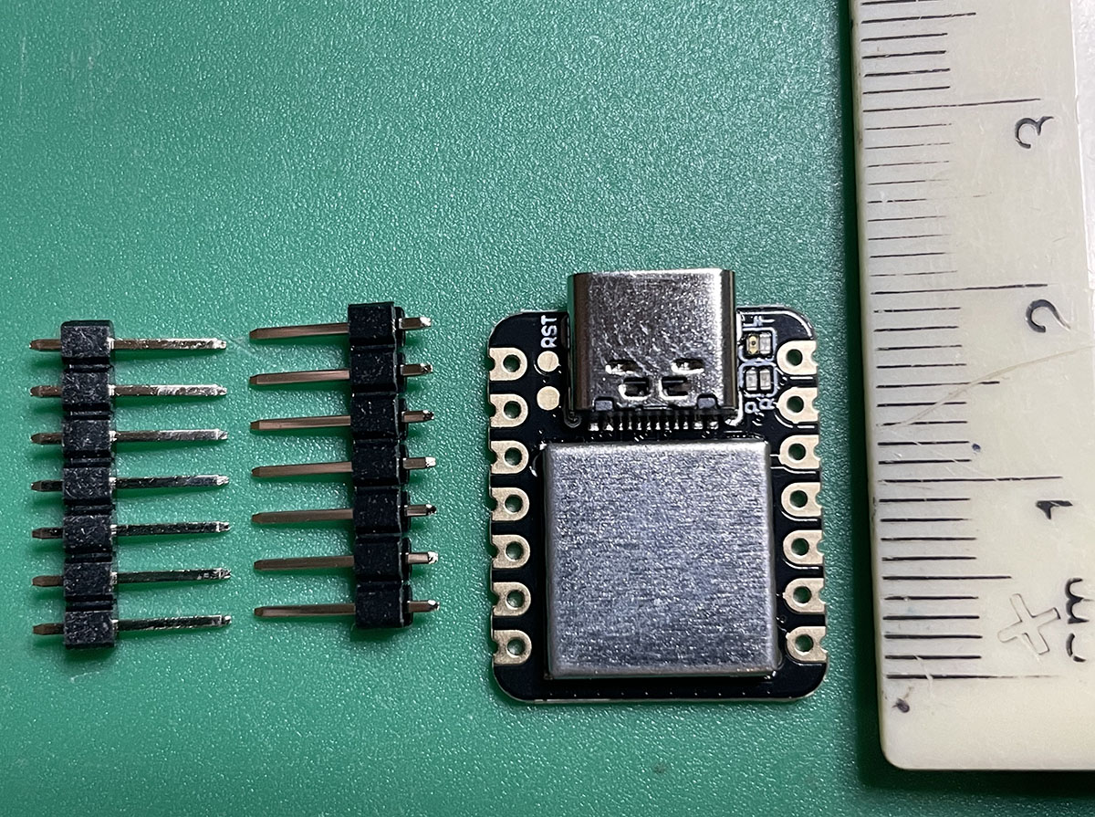

This is a Seeed Xiao for comparison; they also have GND & Vin pads on the underside so the USB port is not essential, once programmed.
There is a 32 bit ARM CPU with plenty of memory in that:
