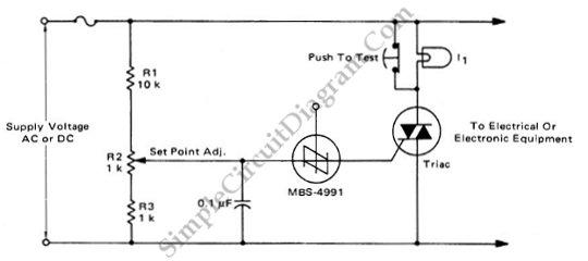

Apparently the triac can do it, only google has no circuit diagrams. I can only find the one (which many reposted) and it doesn't work (it's DC).
Exactly what do you want the crowbar to do?
Your schematic looks like a typical AC dimmer. Definitely not a crowbar. AC or DC might be referring to Universal motors which can operate on AC or DC.
Agreed. So many comments on the web saying a triac can crowbar AC... no schematics to back it up.

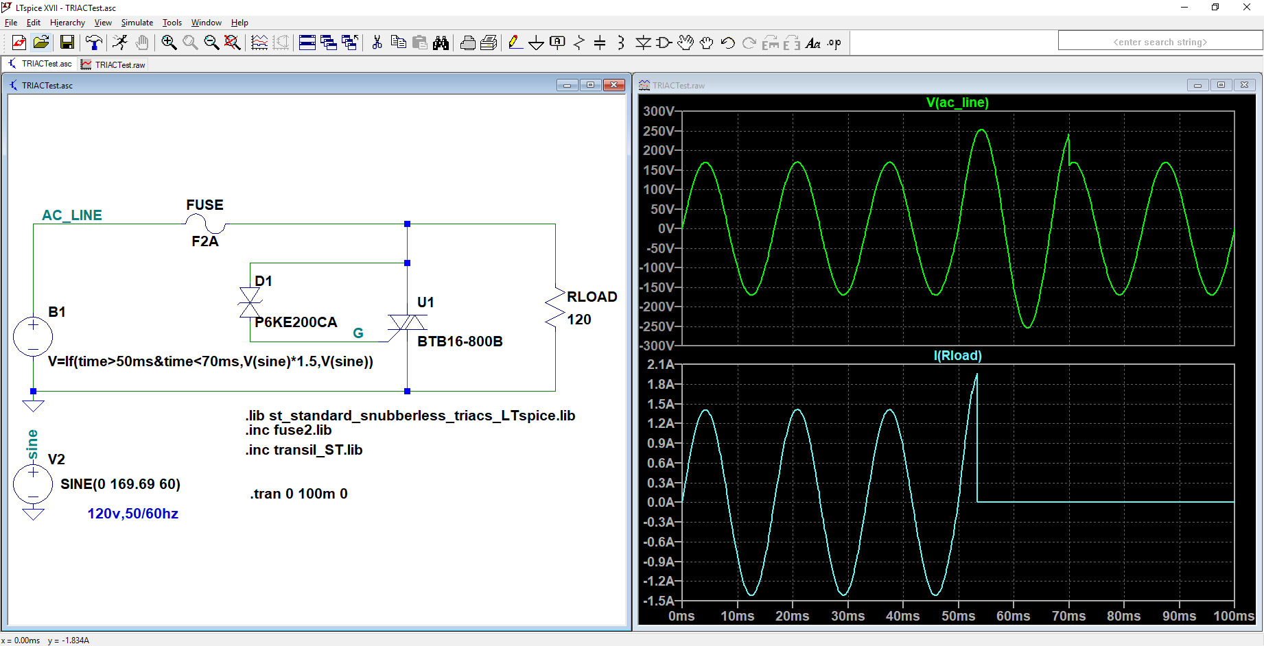

Here's my attempt at a demo
The simulation shows a sudden rise in line voltage between 50-70ms. The fuse blows as shown by the sudden drop of current thru the load.
See OnSemi app note AND8012/D.
eT
I wonder if it's that simple - damn :).

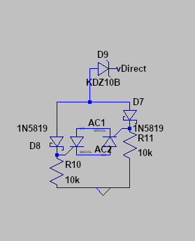

I came up with this using two SCR's!

First circuit looks fine to me - esenntially the same as eTech's in #7. You can adjust the value of the 0.1u cap to trade off noise immunity vs. response time.
It is essentially the same as a dimmer, just that there is no load in series with the triac (except for the fuse).

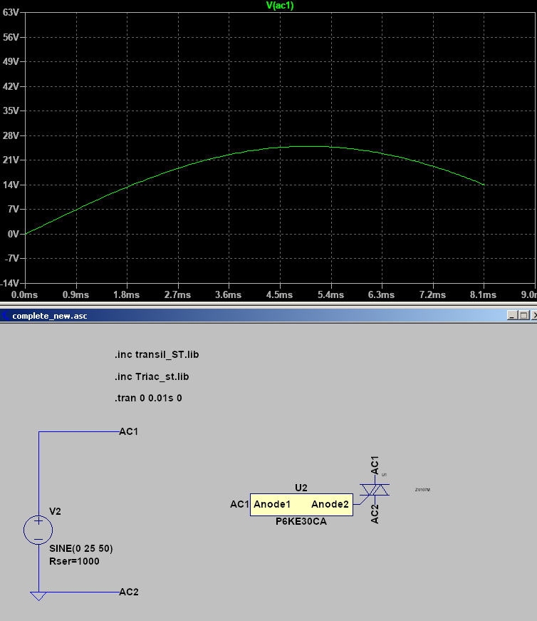

LT Spice keeps getting stuck. I'm using the same libraries as yourself (which you'd posted on another thread).
Have you got the latest LTS executable update? My LTS was randomly freezing until I updated it yesterday.
Build: July 3, 2018 (latest)
It's not randomly freezing, it's going very, very slow!
I've attached the asc file (it's a bit different as I've been playing around to try and make it simulate).
I also wonder why LTSpice copies all the models/symbol files into the users home directory and doesn't sync them.

I had to use a modified version of the triac library and symbol.
I’ll post later this afternoon.
eT
Thought so, any input to the gate caused LTSpice to die. :)
Try adding a few ohm resistor in place of the fuse in the model because spice models don't like infinite current circuits. The crowbar is supposed to represent throwing a crowbar across the bus bars - infinite current and blown fuse.
