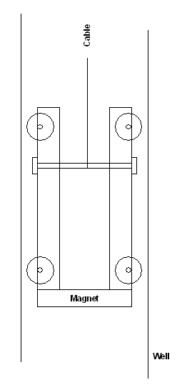

To keep the magnet from sticking to the well casing perhaps you could use a trolley mount, something like this:
Because I am trying to keep it simple and I already have the 3/4" rods set up.
Just an update on my progress. I changed the configuration a little. At the top of the first 3/4" steel rod, I put a cross bar 7" x 1" x 1/2" and connected my winch cable to it. This keeps the whole thing straight up and down in the well casing. The one piece of 3/4" rod still wasn't enough weight to get it to the bottom so I added 12 lbs, of dumbell weights just above the plate the magnet is attatched to. The magnet is so strong that the steel plate sticks to the casing. The good thing about this is that it scrapes all the remaining loose flakes off the inside of the casing. So far I have sent it down only twice and have removed 10 lbs. of metal flakes. I haven't retrieved the 6 lb. weight or the other permanent magnet yet, but they are most likely buried by metal flakes. It all has to come out so I can deepen the well so I will be doing this for an undetermined length of time.

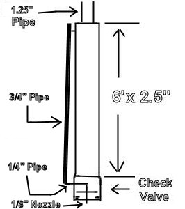

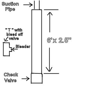

A friend of mine gave me a cool idea today to remove the metal flakes a whole lot faster and easier than a magnet. His idea is to pump it out with a septic tank pumper truck. I will still need the magnet to retrieve the weight and magnet, but the pumper idea for the flakes is cool, huh? The only problem is, I can't afford to hire a pumper truck. So why not build a pump using 3" or 6" PVC? The pump itself I can make out of 1.5" sch 120 with the 3" -6" going from the bottom of the well up and out onto the ground or into a large container. This is going to be cool, and fun.
You can't 'suck' water more than about 35 feet deep. You will need to push water down and let that carry the flakes back up. To get something as heavy as rusted iron flakes to stay in suspension, you will need a high flow rate.
You are correct. That's why I came up with this. The bleeder " T " will go just above the water level to let water drain out and back into the well. When the 6' x 2.5" pipe is full of debris, I haul it up and empty it. More volume per load = fewer loads and finishing sooner. I'm tired of working on this well already. I want it DONE.
