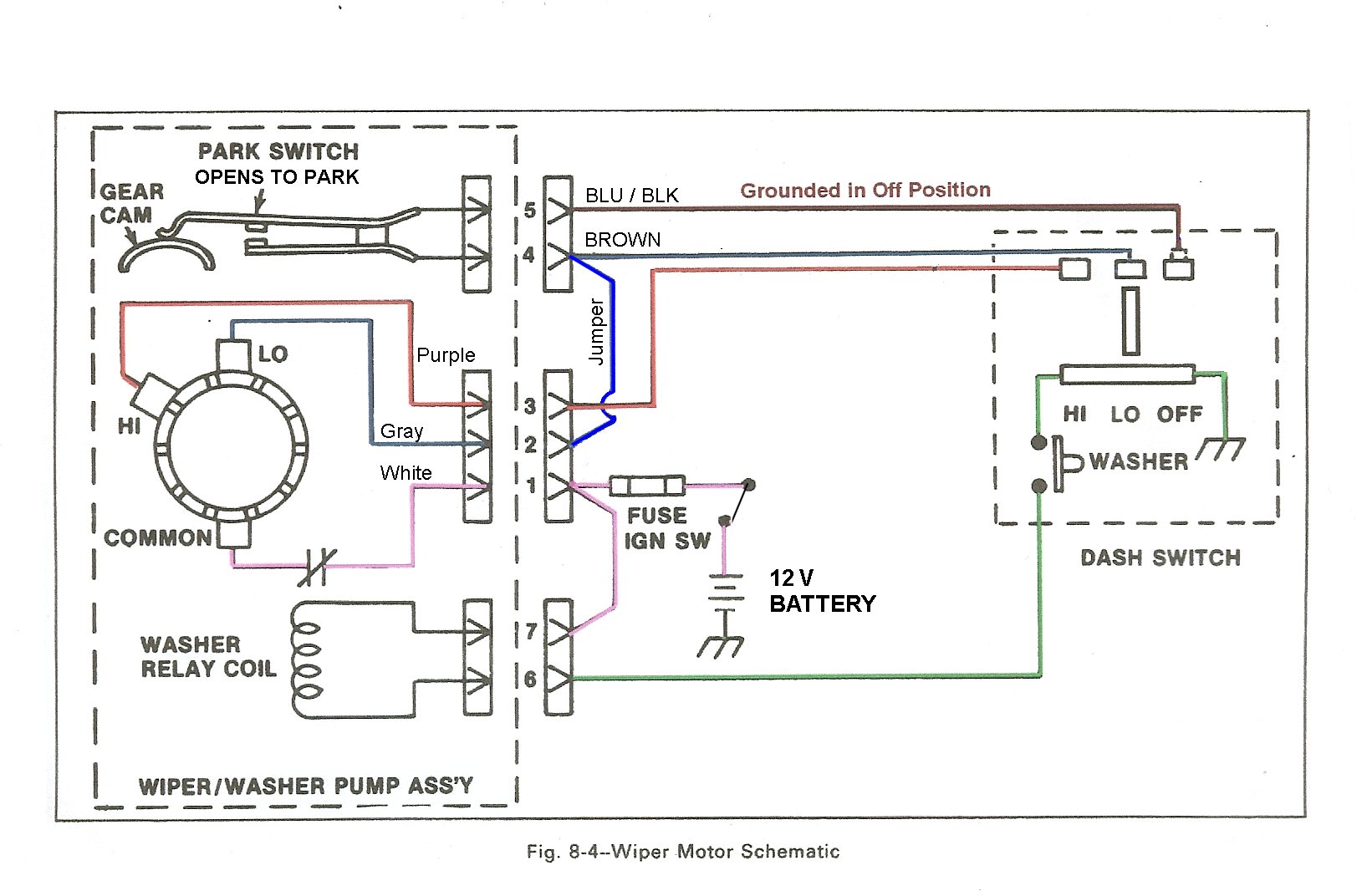

Slow Wipe
Here's a simple Wiper Circuit.
Interrupt the Brown wire of the low speed setting, insert a pulsing on/off circuit with a duty cycle like Mike ML suggested. (F.I. Look into some 555 circuits that pulse a big transistor for this.) This is what the factory intermittent circuit does except it turns on the motor just long enough to bump the wiper off the park node on the wiper gear, then the motor runs it back to the park position until the next pulse bumps it off again.

Thanks for that good answer. No it came off a car but the motor is to drive a bush spit rotisserie off a 12V batterie.
And 44rpm is too fast to roast a pig.
I don't have my workshop and welder now or I would have made a reduction sprocket linkage. Reduction gear boxesare too expensive or too small. Hoepfully I can reduce speed enough without losing too much torque. A whole pig would be too heavy but a 10Kg joint should be o/k?
