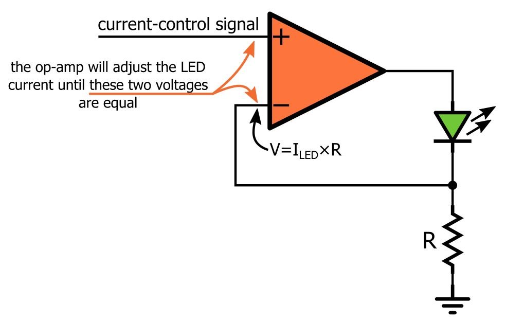

I'd have the opto LED driver opamps in current feedback, rather than "open ended" as you have them.
eg. Connect the opamp output to LED anode and put the load resistor from the cathode to 0V, with the cathode-resistor junction connecting to the inverting input. The non-inverting input voltage will then directly control LED current.
It should give a rather more linear response, as the LED voltage drop is not involved (as long as the supply is adequate and you select the load resistor appropriately.
Use one input opamp to feed the upper driver, then the other as a unity gain inverter with an appropriate bias on the noninverting input, to feed the lower driver.

This is what is being described. See if you can match the description to the drawing. Note in particular that voltage
V(i) = V(fb) as voltage source V1 is being swept over the range 0 to 6 VDC

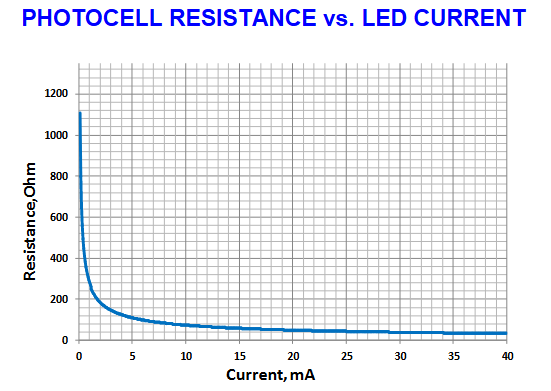

It seems you want to make an optical-isolated stereo attenuator that has only a 20 dB control range in resistance at 5mA used as a differential pair to get 40 dB range. (slightly more with high current.)
There are no specs for matching components or the resistance error at some fixed nominal current.
Is that enough range ?
Is there a reason you need optical isolation perhaps due to common-mode (CM) interference?
There are many ways to control stereo attenuation but it depends on all your expectations.
such as noise levels , distortion, and linear or log control of audio which has a wide log range.
