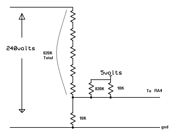

you need to scale and shift the voltage, with an op-amp, to be withing 0to5 volts then use a microchip with an analog to digital controller to read then display the voltage
You can read the voltage with the pic and a voltage divider like this

no you cant, that will give over 5 volts to the pic, 240v ac is what like 330~340v peak? you also don't need such high values
you would be better using an op-amp in front of the a/d, to... like i said, scale and shift the signal to fit the pics requirement of 0 to 5v(or 0 to 3.3v)

Yes you can I don't no what boat you fell off but I been doing this kind of thing
for over 20 years.
You need to read the appnotes before you app your mouth.
Oh using the high value resistors let the EMF diodes in the pic to clamp at vdd it will not go higher only lower But what do I Know LOL

lol you have done this for 20 years and are this clueless!?
240V RMS will be 339peak your 50:1 voltage devider will give +/-6.8volts thats 1.5volts above the Absolute Maximum of a pic and -6.5 bellow the Absolute Maximum!! FFS so what the pic "CAN" clamp that if you keep the input impedance 50,000 times greater than the datasheet says it should be!!(WOW)
so tell me your greatness, how does the analog to digital measure voltage that is being clamped because it is over the Absolute Maximum???
Easy it can read from 0 to 5 so you can read from 0 to 240 not above 240 but to 240 any voltage above VDD will clamp at VDD. Like I said read the appnotes not the datasheet they show how to do things like this.
If the OP needs to take higher reading he can just change the divider values
Any way instead of telling me how you think I'm wrong why don't you show him how you would do it.

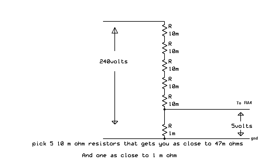

Ignoring the fact that the 240VAC side should most likely need to be isolated from the low voltage 5V PIC supply. Ignoring the fact that the OP probably really wants to measure current:
You could get away with a simple voltage divider method like this if you measured the peak-to-peak voltage in software:

this is much better, still to much impedance
Correct. The resistance values should be half the values shown to give a max 2.5K source impedance.
Somehow my brain thought 5K was the minimum source impedance for PIC ADC. Doh!
It's 10K for 16fxxx chips and 2.5k for 18fxxx chips It don't matter as much as you think for what the op wants to do.
It's 2.5K for 16 series chips, at least all the ones I've used.
Where this come from ? This is from 16fxxx datasheet
And the key word there is recommended impedance
That means if you want the best read time then use this or less
But it don't tell you that what I posted will not work.
when the volts go up impedance is less important.

16F818/819 - looks like it's different for different 16 series devices?.
The maximum recommended impedance
for analog sources is 2.5 kΩ. As the impedance
is decreased, the acquisition time may be decreased.
In any case, if you aim for 2.5K you're satisfying all options.
2.5k, 10k, its all much less than tens of megaohms, thats why i suggest using an op amp then you can have extremly high input impedance for the signal, but very low impedance at the A/D input
at these frequencies an op-amp can be set up as an attenuator(Rf < Ri) and the other input used to shift the AC curcuit up 2.5volts so it is between 0v and 5v
