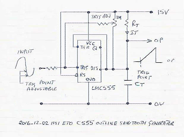

Just a bit of fun really, but Here is an outline circuit for a scope trigger and ramp generator using an LMC555.
The LMC555 Q output can be used for the tube fly-back blanking.

No problem SG,
I know what you mean about not having enough time.:D
By the way, the circuit of post #8 produces a positive-going ramp. If you need a negative going ramp that can be done quite simply.
Also, the ramp in not totally linear, but that can also be sorted.
And finally if you wanted to make a complete time-base generator with precision switched an variable ranges that can be done too, although quite a few components will be required, proportional to the number of ranges you want.
