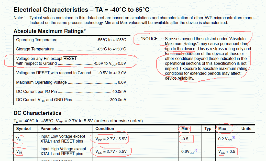

The AVR data sheet is very specific. The relevant section is below. You are not allowed to inject any current into a port pin configured as an input, and you must clamp the voltage at no more than 0.5V more positive than Vdd and no more negative than 0.5V below Vss, which would mean that the input swing is constrained from -0.5V to +5.5V if the Atmel is operated from 5.0V.
Now there are folks on here who have violated these rules and gotten away with it. Should this be a recommendation that you should do it?

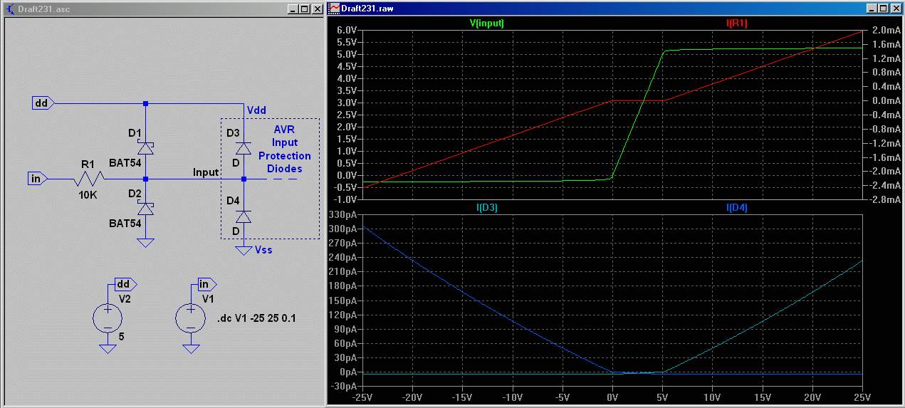

Here is how I would do it:
Note that the voltage is clamped ~+-0.3V using any small Schottky diodes. D2 can be deleted if you know for sure that V(in) will never be negative... You cannot use Silicon Diodes for D1 and D2.

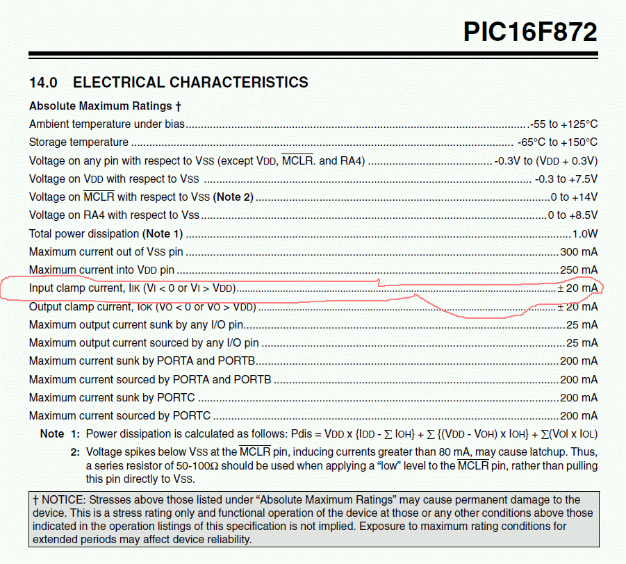

We know that a PIC is made from high speed Cmos. 74HCxx device datasheets from Texas Instruments have a maximum supply voltage and a maximum input clamp current of 20mA. A note says that the input voltage rating may be exceeded if the input current rating is observed.
Here is what MicroChip says on one of their data sheets. Note that the implication is that the device will not latchUp if the current is limited to +-20mA, however, on another line it says that the pin must be constrained to +0.3V above and below Vdd and Vss, respectively. How can you obey both of these constraints simultaneously?

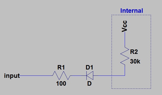

Could always do something like this with single shottky. Provided your input can sink a little current.
