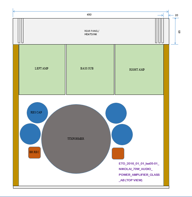

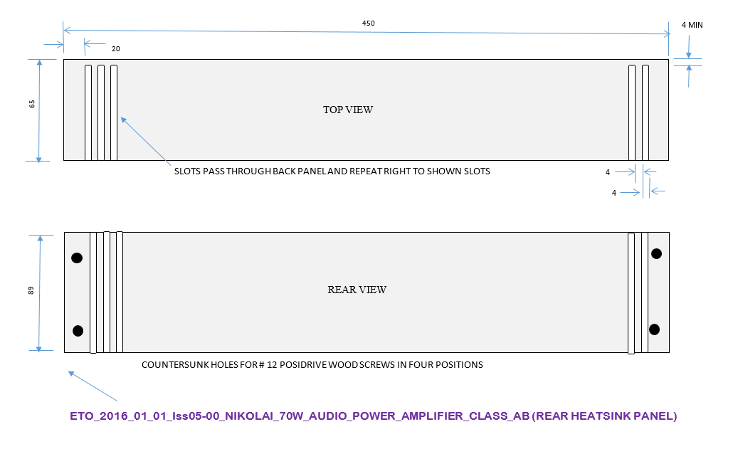

Yes, I can see now that wood would be no good, and wet wood even worse. Do you think you can cast the design I have posted, using lost foam. I can't see how.
Only three things count though with the back panel/ heatsink
(1) Will it be strong enough.
(2) Will it crack
(3) Will it be flat enough and thick enough under the six power transistors?

Thank for your carefully. I say I can unless I'm not lucky ;).
(1) Yes, will strong, alum is a ductile metal unless dross stay inside or air bubbles.
(2) Crack? No, it also cause by ductility. But crack can appear when alum didn't fill the mould fully, wet sand.....
(3) Flat? Yes. You can see this video:
. The sand must be pressed to strong enough that will not fall down when styrofoam evaporate. Sand must be fine; clean from dirty like grass, stone, chips of plastic or glass, and even **** (don't think me like a nasty guy)...
With a long and very big heatsink, I can't trust that sand will not fall down, so I think sand should be added some fine powder like plaster or white cements for two reasons:
+) Fine powders will act like a binder to reinforce sand not to fall down (fine powder pretty sticky)
+) Fine powders also fill small gap between sand grains so the heatsink will be more smooth
Questions: Mounting holes for TO-220 like packages? Room for screw heads? Mill off later? Tapped set-screw could also be used if it could fit between fins?

In view of what I have learned from you about casting, I can see no reason for the rear panel on the rear panel/heatsink (if you folow me). I will thus, re draw the rear panel taking the new information into account. The dimension of the rear panel and general layout will be the same though. How thin could you make the fins. I think 2.5 mm would be about right. Would you be happy with that?
Hi Keep, good observation. The policy I am going for is drill and tap rather than nut and bolt which I hate. I'm hoping the panel, where the output power transistors mount, will be 3mm or more thick which should give plenty of meat for tapping a thread.
Unless TO-3 cans are used, the plastic cased trans will have a bar going across the case in the middle, with two clamping screws, to ensure good thermal conductivity, especially long term. Plastic paks are badly designed, badly made, and make me ill every time I see them, but they are cheap and easy to use.:grumpy:

(1) Arrow should point to hole
ERRATA
(1) Possible design change: bass sub amp and left amp swap positions
NOTES
(1) Phone and mains switching circuits not shown.
(2) The case has 4 x 12 mm approx thick compliant (rubber etc) feet on the bottom
(3) The amplifier boards are mounted approximately 25 mm up from the lower edge of the Back Panel
(4) The left and right panels are wood; hardwood is best: Oak, Walnut, Teak, Rosewood etc
(5) The inner faces of the left and right panels are clad in thin sheet ally (glued with epoxy adhesive or other suitable adhesive)
(6) The entire verticle length of the side panel conductive cladding to be electrically bonded to front and rear panels
(7) Star Point 1 (SP 1) is formed on the back panel near to the IEC mains connector by a tag bolted to the rear panel.
(8) The live and neutral leads from the IEC connector are tightly twisted together and wrapped with at least two layers of aluminium foil, which is held in place by tape. A wire is taped in contact with the foil near the IEC connector. This wire connects to SP1.
(9) The mains cabling from the IEC connector imediately bends vertically and enters the case via an open hole top left in the rear panel inner panel.
(10) The aluminium clad mains cable, is cleated firmly along the inner top of the left cheek.

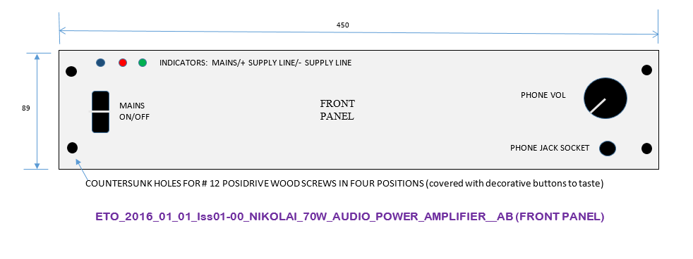

(11) Four screw heads on front panel are hidden by decorative buttons, of user's choice, glued in place

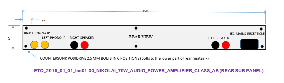

(12) Wiring from rear sub panel passes through holes in the heatsink and is routed under the amps.

ERRATA
(1) Bass sub terminals should be shown to right of centre of sub panel
