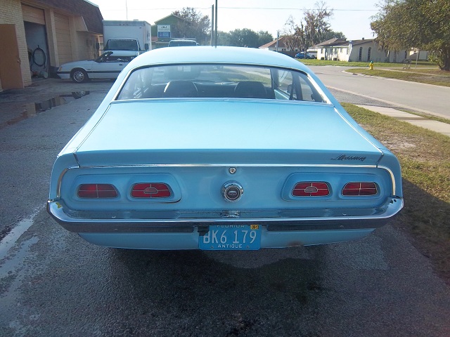

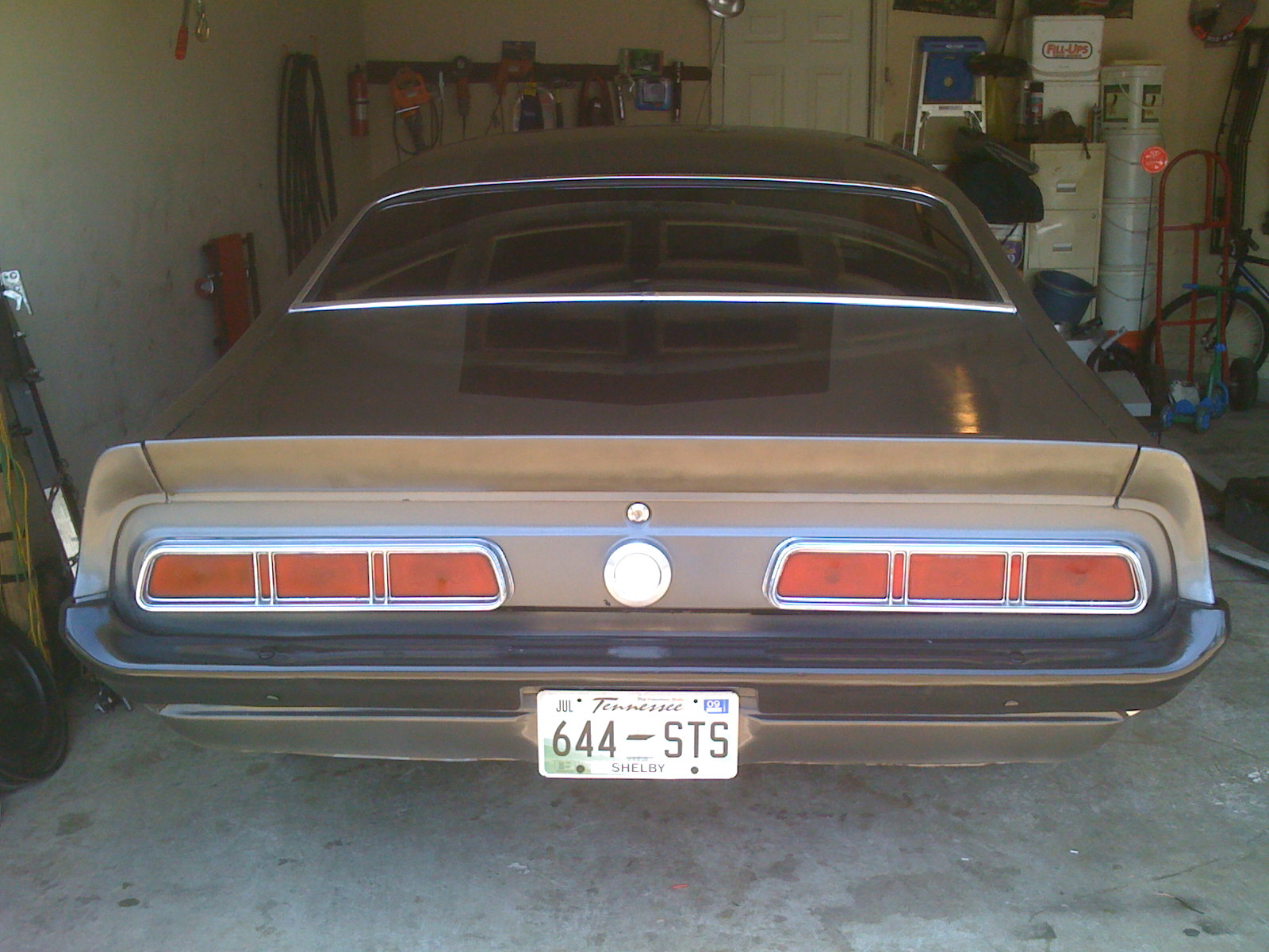

Car is a 1972 Comet, loke a Maverick. We already have it running good, even the A/C works with the old R12. We always thought the tailights were ugly and are replacing them with those from a 67 Impala.

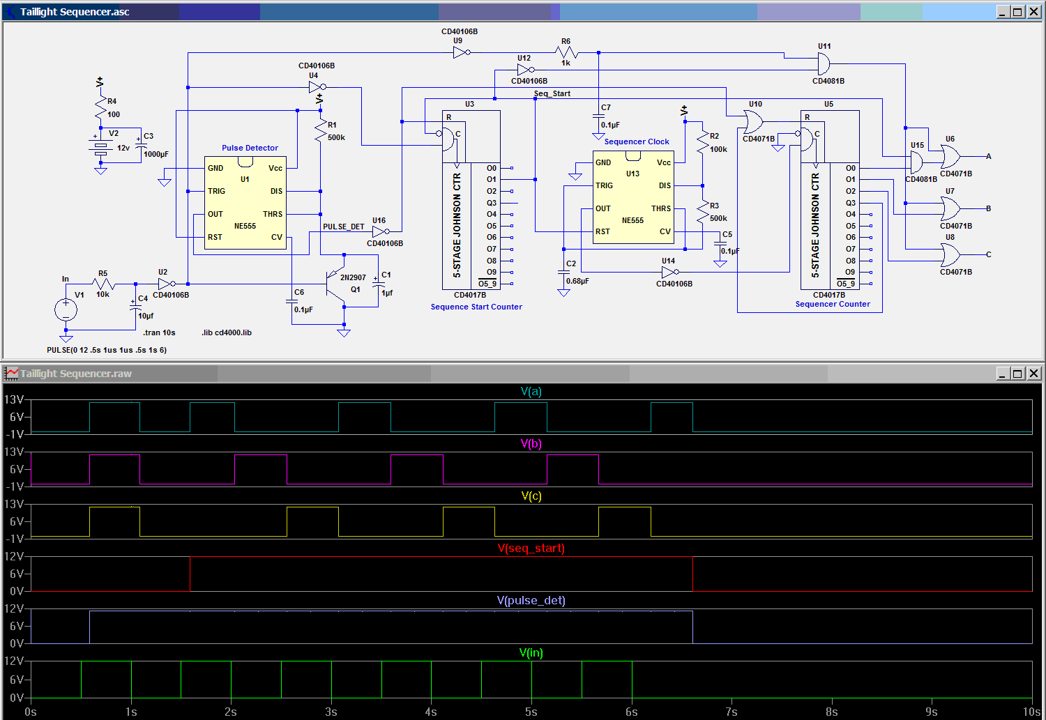

Below is a simulation of my circuit for doing the sequence:
All lights go on when the first pulse arrives.
If it's continuous, as when braking, then all the lights stay on.
If it is the turn-signal sequence, then all lights stay for the first pulse duration and the next pulse starts the sequencer routine.
LTspice doesn't show the pinouts for the devices, or the power and ground for the logic circuits on the schematic so you will need to get those from the data sheets.
The A, B, and C outputs can directly drive grounded source N-MOSFETS, or P-MOSFETS with their sources to +12V (directly to +12V, not V+ on the schematic). The MOSFETS should be rated for 100V or more.
All capacitors should be rated for 20V or more.
Edit: R6 and C7 provide a small delay to avoid a glitch in the sequencer first output pulse.
R1 and R2 should be 1MΩ trimpots so you can adjust the time for the two 555 periods. U1 must be adjusted to have a timeout slightly longer than period of the turn-signals (the schematic is set for a 1 second period). U2 determines the sequence rate of the lights.
Make sure you add 0.1μF caps from each IC power pin to ground for proper decoupling.
Of course you need two of these circuits, one for each set of tail-lights. The 4081 has left over gates which you can share between the two circuits as well as sharing V+. Connect any unused gate inputs to ground.
Since I haven't built the circuit, the actual circuit may operate slightly differently than the simulation shows, but I'm reasonably confident that it will work. If you built it and have any problems, post them and I'm sure we can resolve them.
Edited schematic:

You can help guard against the negative transient by placing a rectifier across C3 in my circuit (anode to ground).
I think my circuit pretty well meets the constraints of his requirements. :)

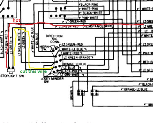

The simplest way to do this without any delay or false signals is to have a separate line from the brake switch to the back of the car. Cut the wire going from the brake switch to the turn signal switch and run it to the back. Now it is simple logic:

original Comet tailights
What it will look like with "new" tailights
partial schematic of car- note wire from brake switch to turn signal switch.

If I understand you correctly, my circuit does that without any added brake signal needed, assuming that in your present circuit, the turn-signal on the single wire to the appropriate side keeps pulsing whether the brakes are applied or not.
