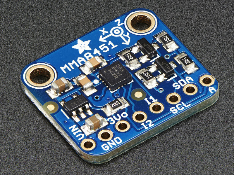

Specifically... 14 or 16 bit ones.. I use the MMA8451Q
I get mine from farnell but search for this.
Mine are only £6.. and are quite accurate. There is a library for XC8 and also one for the ardunio if you go that route.

Ian Rogers the MMA8451 looks really good. I'm showing $32 for the breakout at Farnell here in the US. It looks like you can get the IC for $1.17 from LCSC. Might be worth it for me to sort out the circuit and include it on my board. Thank you for letting me know about it!
Ian Rogers Yeah, I see it being sold pretty cheaply elsewhere too. The more I look into it, the more I like it.
I think I'll have some PCBs printed even if it ends up costing more. I'd like to do it myself bc it'll ultimately be integrated with the circuit board of the device. That way I can make sure everything is working with the exact same parts and everything. Besides that, I'm looking for an excuse to use the reflow toaster oven I just built.
The circuit looks dead simple. I'm still very much a novice at creating PCBs. The only question I really have with this is if it's ok to use the same 3.3v for the Interface Voltage and the VDD? Or is there some reason they should be isolated from each other that I don't understand?

The breakout board schematic is here
Note* I said Sparkfun.. The mma8451q is an Adafruit board, the sparkfun board is an mma8452q
Same pinout..
Cool! Thanks for the link. I did see it before but figured I'd draw up my own bc I'll be using an esp32. So I shouldn't need the voltage regulator or the level-shifting stuff. I did just take a second look though and see they do have interface and VDD tied together.
Hey man thanks again! You've really helped me sort this all out.

Ian Rogers I finally received my boards, a month later, from JLCPCB. I thought I'd share the results.
The IC was difficult because I kept bridging the solder paste. The unit itself works well. I'm only getting about 50hz out of it though. I think it might be because I'm printing the results.
Cool!
What do you mean 50Hz? You mean 50 reads a second? The chip is good for 400khz
but sending ID then address, then resending address in read mode and reading..
5 bytes plus ACK stop start etc.. Say 6 bytes @ 400Khz continuously is 66.6Khz
50 times + outputting serial to read.. I know 9600 baud is 1ms so depending on the print line command
even if you send 3 bytes that will be @ 20ms (ish) + I2C read of 15us is 20.015mS so 50 of them will be about right.
