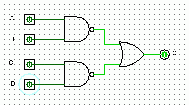

Make a truth table for this circuit: It has four inputs, so only 16 states. What logic function is it equivalent to?
I see it now, thanks Mike. I get myself confused with active and unactive outputs, i build it that way a few times im sure and when I looked at it , i thought well that wont work. Thinking too hard. Thanks again
