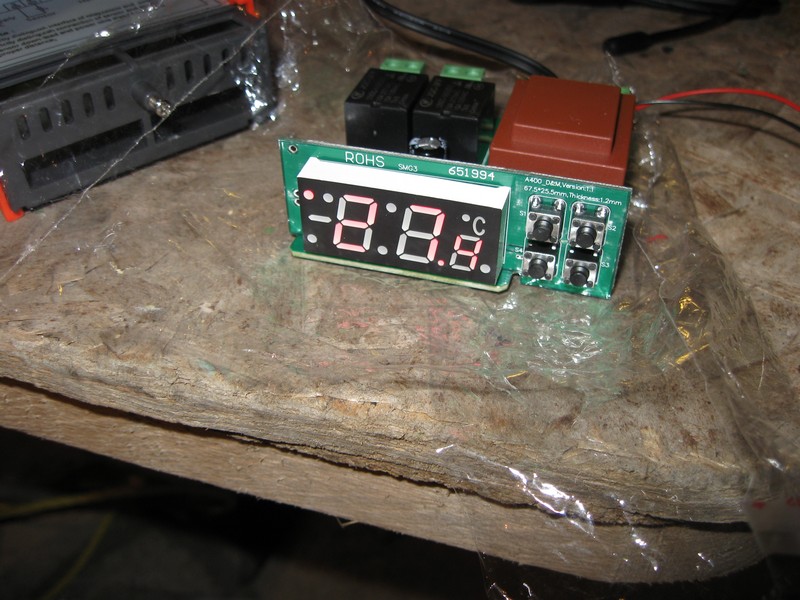

I ordered a temperature controller from Asia and received the 230 volt model instead of 115v needed. I know, buyer beware etc...
Could reorder at about $25, but my pride says 'fix it'
Had it jury rigged with my 5kw 230v heater; I know it works.
Can someone point me to a replacement power supply?

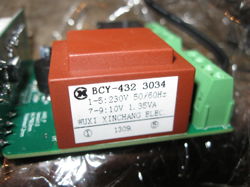

The on-board unit is:
BCY-432 3034
230v 50/60hz input
10v 1.35va output
WUXI XINCHANG ELEC
Best bet would be direct replacement 115v - where can I get one?
Other options: 9v battery? power brick? It will be going in a project box and controlling a keezer so all circuits can be hidden.

I tried 120v and the display and sensor seemed happy, but voltage seemed too low to close relays. Laser thermometer showed no heating.
A bit rusty on electronics, but at 225v, multimeter showed about 14 volts AC. Seems to me that would be 'peak'.
At 120v, got about 6v output, apparently not enough for the relays.
Supply dimensions are about 28x33 mm, 22 mm high. Where do I find a replacement?

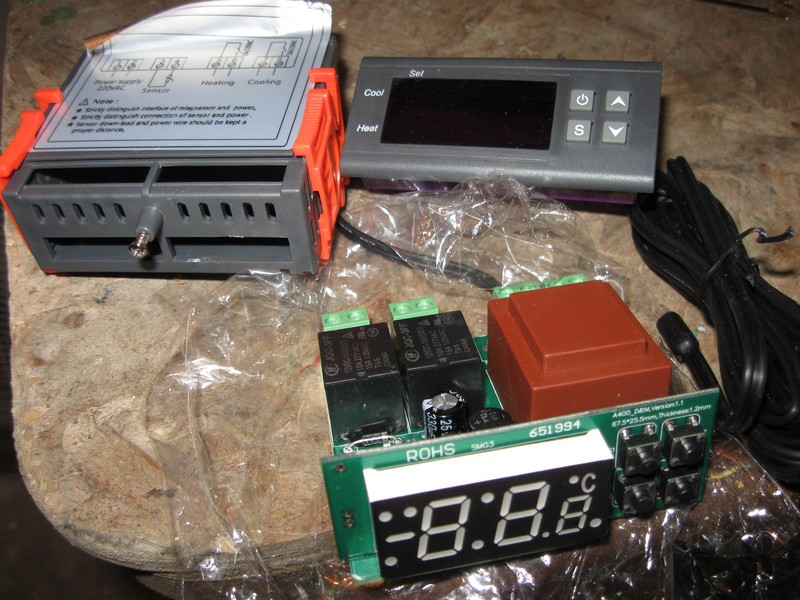

Can you post bigger (not huge!) pics (particularly pics 2 and 3) so that we can read the text and see other details?
Is that red block the 'supply'? If so, it could be a conventional tranny rather than SMPS.
Text was in post one. Will re-tool photos.
The red block definitely looks like a conventional PCB-mount mains transformer. With a bit of luck you would be able to source a 110-Volt one with the same output ratings, physical size and pin positions. Then get busy with the solder-sucker and soldering iron :).
Even if the pin positions weren't identical it looks as though you have enough copper area to drill holes and do a safe mod.
Edit: I suppose another option would be to replace the relays with 6V coil types?
The replacement with a 110 is what I have been hoping for all along. Since they send out basically the same product in two voltages, what are the odds the transformer is the same one, only centre tapped for the 110? I may be able to open it and re configure.
What/who would be good starting points for looking for pcb mount replacement trans? How are those parts listed? What manufacturer? (to focus my Google search). I have been unable to track down much on XINCHANG
I see only two pcb connections to pins of what I presume is the primary, so the chances of finding a centre-tap look slim :(. I doubt re-configuring is possible: the windings are probably potted in goo, with the primary innermost.

Thanks for the photos it's definitely a normal power transformer.
Your under-PCB photo shows only two pins into the tranny and two pins out, so it should be very easy to replace that tranny with a 110v one.
Since you said the output was 14v AC when running on 225v AC, that looks like a common cheap 240v->12v transformer (that will output 15-16v at 240v in). You can replace it with a 110v->12v tranny of roughly the same size, very simply as there are only two wires on each winding.
If you have a 12v wallwart (plugpack) of the right size you can extract the tranny from that. Wallwarts are a good source of small transformers.
@MrRB
The label says 10V, 1.35VA.
