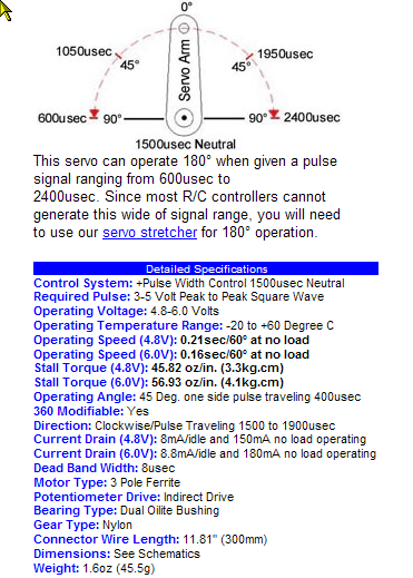

I need to buy a servo able to rotate not less than 180º.

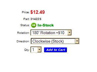

Since I do not need too much torque but the 180º rotation capability I browsed the list of Hitec servos at servocity.com.
For all standard analog servos I checked so far, like this
they seem to offer them able to rotate 180º if you pay extra 10 USD. Is my interpretation correct?
Hitec is not clear if they analog servos are able to rotate 180º, out of the box. If so, why that extra charge?
What servo similar to this could I buy being sure that it will be able to do that 180º (not less!) rotation? If Hitec, better (to maintain consistency with their splines).
Just in case: I do not like to buy digital...and then a programmer and so on. No thanks.
Really this is a new world for me!!
The way I read it is, that servo can operate over 180deg providing the controller can drive it with 180deg signal range ie: 600uS thru 2400uS, which it says MOST controllers cannot do.
So if you have a controller that cannot supply the 600/2400uS you need that stretcher/extender,,, how do you plan to drive the servo.?
My own PWM signal.

I plan to drive it with my own PWM signal ranging from 600 to 2400 us.

They specify the required drive voltage levels that are required to meet the specification.

I would contact that supplier and tell them that their advertised spec for this servo is misleading.
Just rechecked the site, they claim to have a 180deg in stock.!!!!
