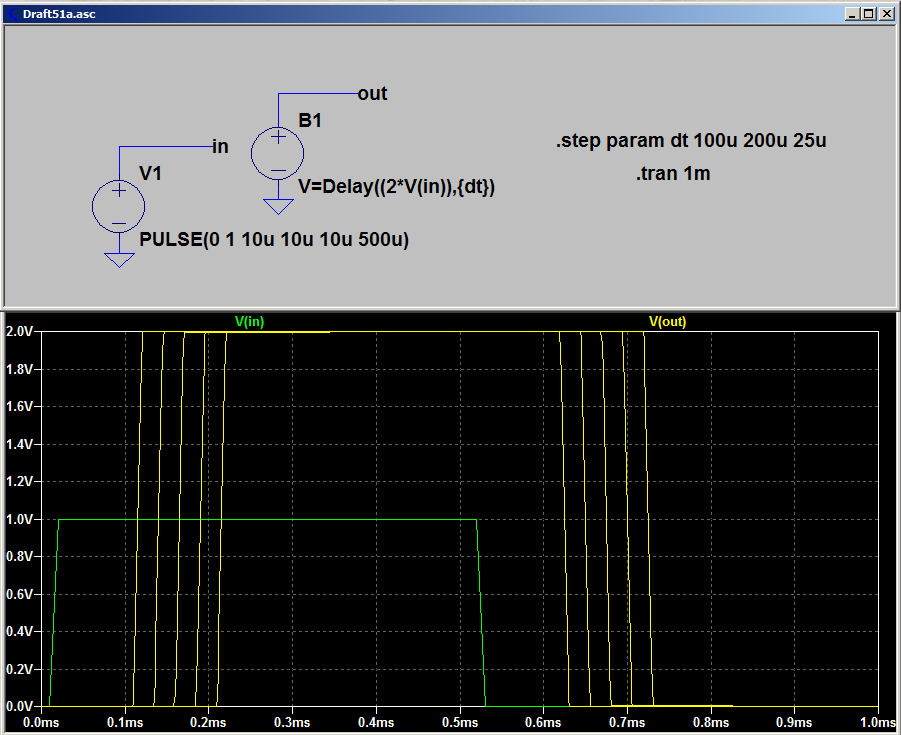

Is there any way so that i can input this equation to the SPICE tool and plot Delay Vs supply voltage?

You can use the DELAY function to characterise a Behavioral Voltage or Behavioral Current source.
My first step would be to implement and simulate an inverter using a particular technology node and plot delay vs supply voltage graph for different values of Vth.
Next i want to validate my model against the simulated one using my proposed equation and compare the 2 graphs...since i m knew to SPICE i dont know how to go ahead with the second step..
I basically want to know how can i enter the mentioned equation n plot the graph for different values of Vth,Vth1, Vth2 and supply voltage?
Here how the Delay() function works in an Behavioral Voltage Source expression:
I delay V(in) by 200us, and multiply it by 2. Read the LTSpice Help file for circuit element B.

Here is how you vary the delay timing:
You can make either argument to Delay() a function of various things. Either argument can be an arbitrarily complex expression which is a function of some node voltage, branch current, or a varying parameter as I show above.

I don't wish to introduce delay in my waveform but rather i want to calculate the delay of the inverter using my proposed equation. The simulated circuit can be used to calculate delay..this i m aware of..but in the second step i want to validate my proposed model against the simulated one...so how do i do this?
