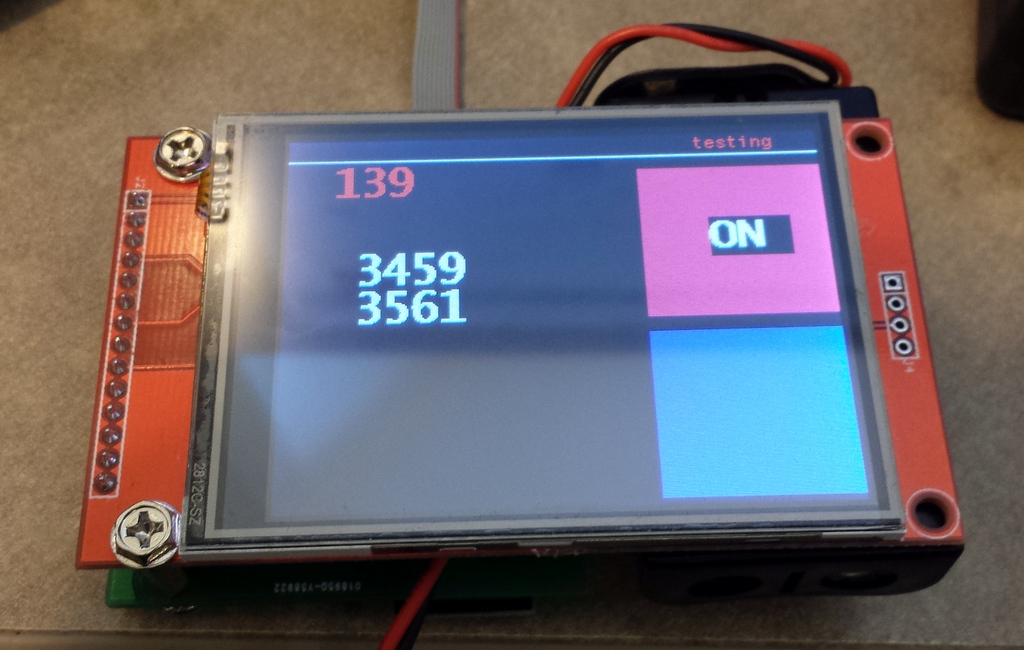

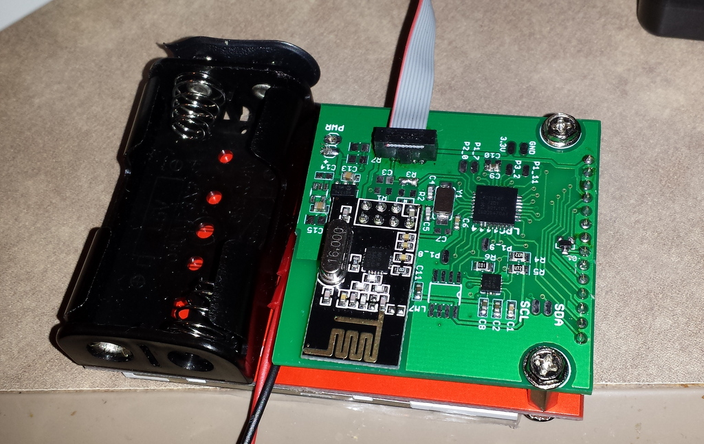

I got one of these displays about 2 months ago and found them great, so I started basing some projects around them.
I've made this PCB that fits right on the back of the LCD display. My purpose is to make this into a touch screen remote. Simple home automation stuff. Talk to dimmers and my gas fireplace and whatever else I can think of. The board and display is pretty versatile though. I have another non-touch one I'll be using as a graph and display showing power usage and environment stuff for my camper/trailer.
Unfortunately I put all the pins upside down for the display. This PCB is supposed to have the components face the inside and have a blank board on the outside. I ordered a new set of boards with the correct pin orientation.
