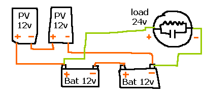

hi.. thank you so much for all your replies.. i really appreciate it.. this is my new circuit.. will this be able to sustain my project? i welcome any comments.. thanks again
ok est your batteries should be able to power the load for 24V x .5A=12W so 70aH / .5aH = 140 hrs (fully drained) ... your panels when at peak performance supply 50W / 24V = 2.08aH ... your load consumes aprox .5aH so for every peak hour you panels can only supply enough energy to power you load for 4 hours 2.08aH / .5aH = 4hrs .... so you would need 24 / 4 = 6 peak hours of solar production on a daily basis to keep up with your load ... that is cutting it a little thin and also depends on your location... in a sunny location say US Arizona you might get away with it ... at a more polar location Canada, Ontario you would probably not be able to maintain the load... of course a solar tracker would help. :eek:)
Each solar panel is 50W (about 4A, not 2.08aH). So the break even point is nearer to 3 hours of sunlight per day. Your reserve is 140 hours, or almost 6 days. If you drain your reserve completely, it will take 8 or more sunny days to replenish. Over the long term, the sunny days must be more numerous than the cloudy days, although you might get some power during a light overcast.
The fan should have a low voltage cutout so it doesn't damage the batteries by discharging them too deeply. If your fan is "24V" you might save a little power by making sure it doesn't use more power when the battery is charging and its terminals are 28V.
The PV array was probably rated at the Equator, and should be adjusted accordingly by latitude, climate, and season.
Charging specifications call for a float voltage of 2.25 volts per cell for a led acid battery. Since a 12 volt led acid battery has 6 cells, the float voltage should be 13.5 volts. To charge a series stack of 12 cells, the charging voltage has to be 27 volts minimum to obtain a full charge. To get a quick charge when the sun is available, you will have to have an even higher voltage available to get to the 90% charge point. Then you can switch to float operation. As long as your solar controller can monitor the charge state of the batteries to prevent over charging, I don’t see a problem that hasn’t already been beaten to death by the other replies.
I did not intend to define a proper solar controller. I had hoped that mentioning some voltages would not confuse a careful reader. When charging or float potentials are being applied to the batteries, those voltages are greater than 24V and would also appear at the load.
If a voltage at the load greater than 24V causes waste, then it might be worthwhile to regulate the load.
And it would be wise to equip the load with a low voltage cutoff to prevent discharging the battery beyond recovery.
