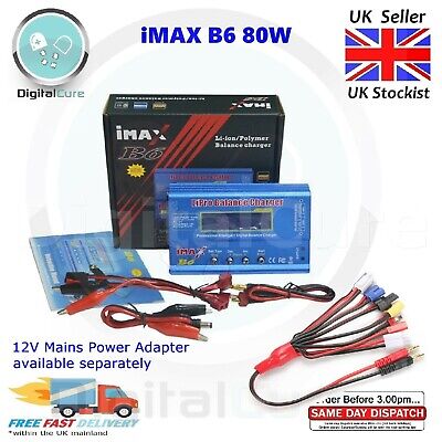

You also need a "Balance charger" such as one of these; both the battery power connector and the small multipin connector must be connected whilst the battery is being charged - chargers such as these control the voltage on each cell in the battery, to avoid the possibility of overcharging - which can cause a battery to burst or catch fire.
