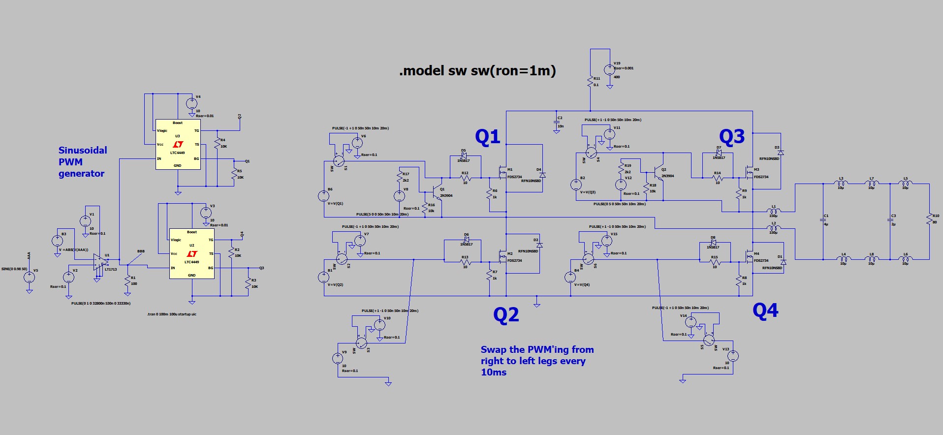

Sinusoidal mains inverter is a cinch?
Flyback
Why is the sinusoidal mains inverter said to be so difficult to design?
The attached LTspice does it no problem..
There is no need even to adjust the amplitude of the reference sine wave.
If you change the load on the output, it automatically changes the sinusoidal current to suit it...and puts the same sine voltage across it.
All open loop!
Why is this said to be so difficult?
(Not Grid_tied here, of course)
Generating the ref sine signal....i'd say this is best done by a mini LLC converter, wouldnt you agree?....tap off the sine with a current transformer, and use that as the ref sine? Big L and C values for 50Hz sine, but low current. AYK, its a train of half-sines thats actually needed (rectified sine)
As you know, when the load is purely a resistor of constant value, then the simple inverter principle above applies, but when there is rapid load changing , or non linear loads, then we need a control algorithm to be added.

  • Inverter_2_a.asc

Thanks, overload protection would do with a hall sensor chip in the bridge. AC input type.
Would just turn off if overload current seen..
Comparator at output of hall sensor.
Then cust would have to power cycle to get it back on. (hopefully theyd remove the overload)
overload protection would do with a hall sensor chip int he bridge. AC input type.
Yep, that's the easy bit.
Plus inrush control if it's anything other than trivial power rating.
What about the ten (at least) "cheat" voltage sources you are using to create control signals?
Try adding all those in full, then see if you still think it's simple!

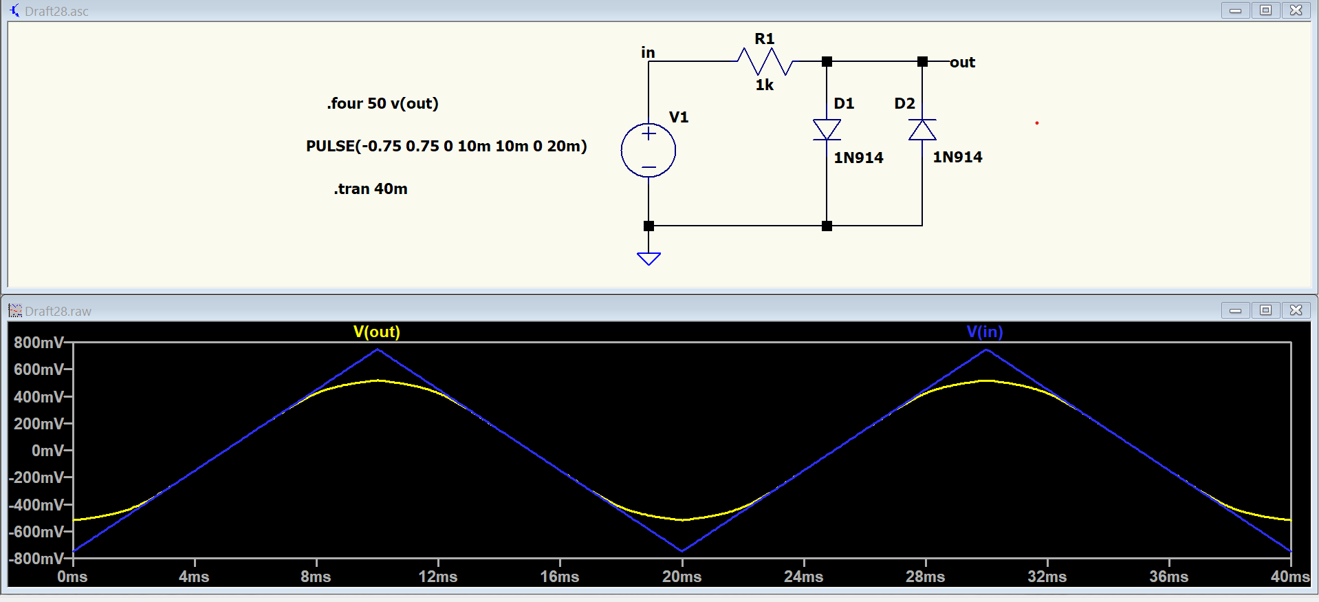

thanks, only other (analog) way to make a 50Hz sine i can see at the moment is to rc filter a 50Hz square wave, and then amplify it back up? Plus ideal diode rectification because we only want a train of positive haversines....of about 1V peak.
How about this analogue approach? :
THD is only 1.4% in the sim.
Thanks, the sim of it is now flashed out to more real circuitry, but it takes ages to run....
  • 50hzINVERTER_jan3_SINE CHEAT.asc
