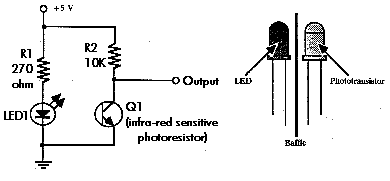

We have a sports training product under development and need help with the electronic part. The idea is to have a sensor that detects when a person is within 2 to 3 feet and then send a signal to a small electric motor. Is there a sensor on the market that would do this or that we could modify fairly easily???
Thanks for any help
Scott
Hey, you can make it from junk..
coupled with a Monostable multi vibrator using 555
Yes, I agree with magnatro that you can make it with two infrared LEDs, one is emitting infrared and another is receiving the reflected ray. If a person is near the receiving one, its receiving signal will intensify significant so that you can easily get a trigger to moter with comparing the receiving signal to a constant voltage. Also you can adjust the constant voltage to get a appropriate detecting distance.
I have once made such a detector with RP222( 2Ir LED) and a single chip, and it can detect an object within one feet. It could work stable.
