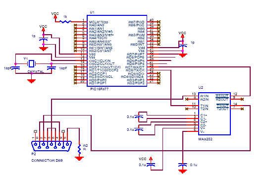

See below for the basic PIC/RS232 schematic. You're definately going to need something like this if your robot is to have some form of advanced control. I don't know how much you know about pic programming, but I would recommend that you play around with external interrupts (useful for quadrature encoder readings (i.e. measures distance travelled)), analog pins (good for analog sensors), timers and PWM generators. This stuff is pretty easy but if you got crappy encoders or sensors they could really complicate things. Anyway robot sensors are pretty much "plug and play" except that you might need decoupling capacitors.

i am not familiar with pic programming, but i do know assembly and c. if i were to buy a kit, is there anything you would suggest that would be a challenge, and contain programming and soldering?
