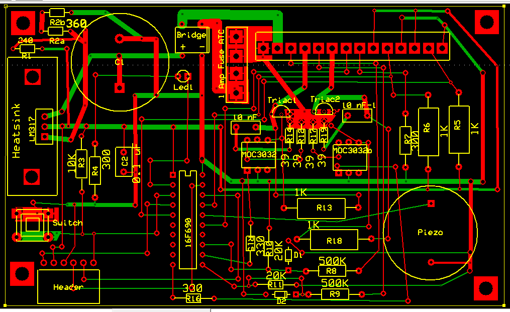

I designed a PCB using ExpressSCH and ExpressPCB. After spending a massive amount of time designing the 3"x 5" 2 layer board,I learned that the company I downloaded the design software from wants to charge $70 per board.
1) Is this a reasonable price?
2) If not, please recommend another manufacturer. Ideally, I would like the manufacturer to accept .sch and .pcb files.
Have you tried making it smaller? If you are willing to share the design here I expect we can help you cut it down maybe by as much as 1/2 unless it is a power board with a lot of large parts like relays.
I use OSHpark which charges $5 a sq inch but you get 3 copies of the board for that.
I'm imagine I can replace some of the larger resistors with smaller ones. C1 is 4700 uF.

You can easily shrink this board by 50%. I would start by moving the large cap and the pizeo buzzer to the back side of the PCB if you can. I see physically large resistors connected with tiny traces. This does not make sense.
Look at other PCB layouts and see what you can do different too.
Edit: by all means. Use the smallest resistors the circuit will be happy with. For logic circuits I use 1/8 watt through hole resistors for through hole designs.
