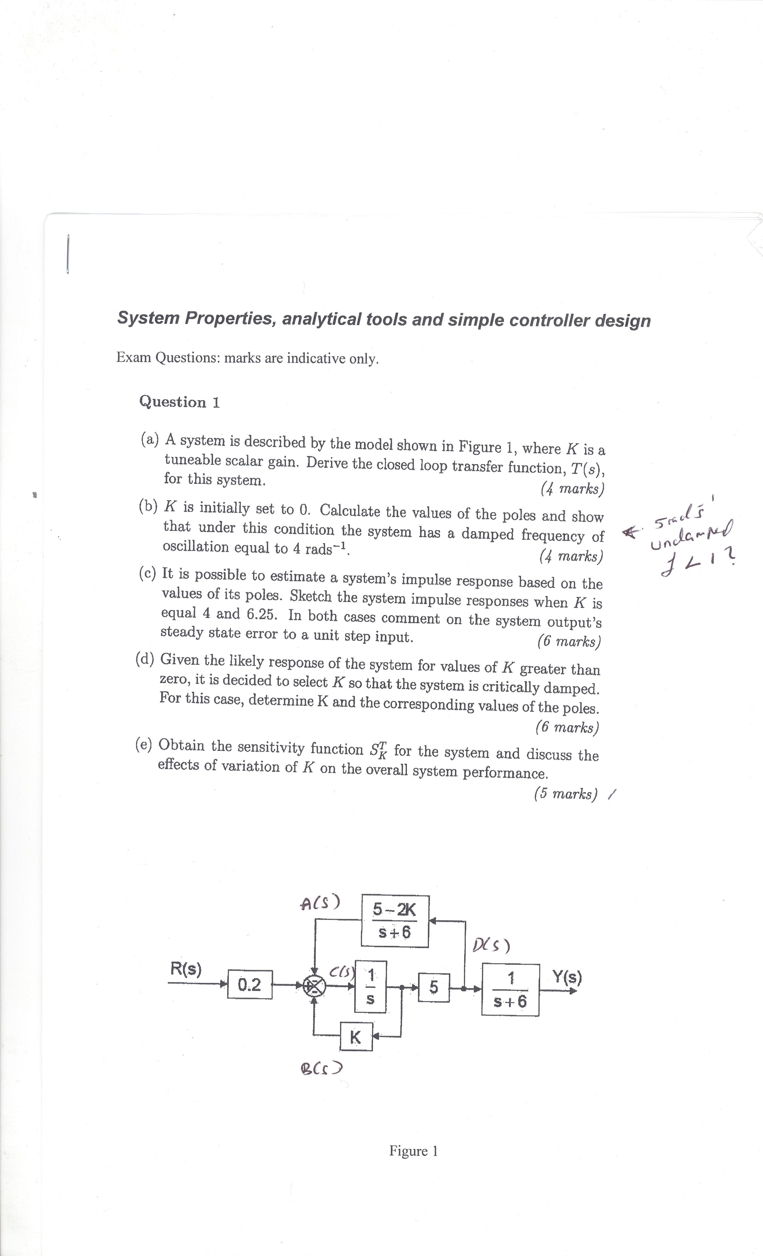

Hey guys, I have attached Q1 of my tutorial sheet on here. If you look at part B it says that I should show how the system is damped and that the "damped frequency of osciallation" is 4rad/s
But in my case, I got the transfer function to be:
1/(s^2 + s(6+k) -4k + 25), which give me two complex poles: -3±4j
Now (unless my transfer function is wrong) this system is an undamped system since 0<ζ<1
and Wn = 5.
What am I doing wrong?
Hope you can help!
Fouad.

ahh so I guess the lecturer was wrong? (since it explicity says in the question to prove that the "damped" system has a Wn = 4?
Thanks!
Well, there's nothing wrong with saying that the system is a 'damped oscillation'. If it wasnt damped, it would be an oscillator or totally unstable. The question is only whether or not it is underdamped, overdamped, or critically damped, but all three of these are still considered 'damped'. In other words, a damped system has response like this:
f(t)=e^at *(A*sin(wt)+B*cos(wt)), {a<0}
or similar. If you look at that kind of response you'll see that it oscillates but gradually 'damps' out after some time t rather than continually oscillating because of the "a" exponent being negative. Thus it is called a "damped oscillation".
You found roots with real part -3 and imaginary part +/- 4, so the damped frequency of oscillation is 4, so w=4 in the equation for f(t) above.
The exponential factor is -3, so a above would be equal to -3.
So you did it right, you just didnt interpret the results correctly. Overdamped is damped so much there's no oscillation, underdamped is damped less such that there is still an oscillation for some time period less than infinity, and critically damped is right in the middle somewhere.
Oh yeah, that's not exactly the transfer function is it? What happened to the numerator?
The system is always damped when 'a' is less than zero.

Im sorry i must have been zoomed when i looked at that block diagram so i didnt see the 1/(s+a).
But, your first post said you were looking at part B which says K=0, so i did K=0, and came up with the transfer function:
H(s)=1/(s^2+6*s+25)
which has roots at -3 +/- 4 which means it is a damped sinusoidal as noted previously. I'll check out other values of K next and we can compare notes.
In the mean time, see what you get for K=0.

Okay, so I have now worked through all the tasks and I got the following results:
Q1)
a) G(s) = 1/((s^2) + s(6+k) -4k + 25))
b) K=0, S = -3±4j
(I asked my lecturer and he said the frequency of oscillation in this question is the imaginary part of the poles, i.e. 4 as shown in the question)
c) When K = 4, S = -1, -9 and to get the impulse response we do Inverse laplace of the transfer function and get the response shown below:
y1(t) = Inv Laplace G1(t) = g1(t) = (e(^-t) - e^(-9t))/8
see here: https://www.wolframalpha.com/input/?i=y =(e^(-x) - e^(-9x))/8
When K = 6.25, S = 0, -12.25
y2(t) = Inv Laplace G2(t) = g2(t) = (1/(12.25))*(1-e^(-12.25t))
see here: https://www.wolframalpha.com/input/?i=y+=+(1/(12.25))*(1-e^(-12.25x))
Steady State error:
Unit step R(s) = 1/s
Since Y(s) = R(s)G(s)
When K = 4:
E(s) = R(s) - Y(s) = R(s)(1-G(s))
E(s) = (1/s)*(1-(1/s^(2)+10s+9))
**Using final value theorem**
e∞ = Lim s->0 sE(s) =(1-(1/9)) = 8/9
When K = 6.25
E(s) = (1/s)*(1-(1/s^(2)+12.25s))
e∞ = (1-(1/0)) = undefined
d)
system is critically damped when ζ = 1.
using the general characteristic equation:
s^(2)+ 2ζwns + wn^(2) = 0
It's critically damped when k = 2.12, -30.12
(if these values are correct then getting the poles are easy, since we only need to substiture them into the characteristic equation and solve for s)
e)
S(T,k) = k(s-4)/((s^2) + s(6+k) -4k + 25))
It's at this point I am unsure what to do... if I did the sensitivity correct, then what happens as K changes? do we look at S(T,k) as k->∞ and k->0?

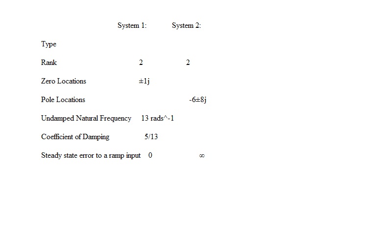

Also I am now trying to answer Q2)
It says:
For each system, derive the simplest transfer function and determine the missing information in order to complete table ( see attached pic)
When attampting to fill in the values for the first system I get the pole
locations by using the general characteristic equation:
s^(2) + 2ζwn + wn^(2) = 0
ζ = 5/13 and wn = 13, we get s = -5±12j
In this case, how can the rank be 2?
Is'nt the rank just the number of poles - number of zeroes?
Shouldn't the rank be 0? if not, then wouldnt we need to get 4 poles in order to get a rank of 2 (since we already know that the number of zeroes is 2?)

The rank would be the rank of the matrix required if the characteristic equation was converted into a matrix. That would mean the rank would be 2 for a second order system.
