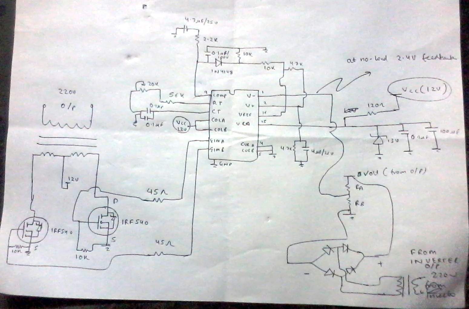

HI,
I have made Inverter using 600VA transformer of Center type using SG3524 PWM controller with feedback....it was working fine.
Now i am trying to make PWM using PIC16F877A so, i need your suggestion that two channel of PWM should be used or any good suggestion i need from you.......
Could we see the schematic of your SG3524 inverter?
Have you now given up on SCADA?
I want to know just that will ADC to PWM will work or we have to create another method for voltage regulation at output??
