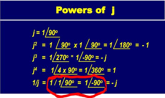

power of j
hanhan
How can you know this?
power-of-j-jpg.74782
Thanks for help.
You multiply the first (in red circle) with:
-90 / -90
The above is same as 1. And when you multiply with one, you do not change the value.
You get:
1 (-90) / 1 (90 - 90)
which is:
1 (-90) / 1
which is
1 (-90)
I omitted the angle symbols. I hope that was readable.
Thanks misterT! I understand your proof now.
Can you help me explain it considering j as an rotate operator? I want to understand what does this really mean?

There is a much simpler way to understand this and that is through the idea that the operator 'j' is the square root of minus 1: j=sqrt(-1).
This produces an imaginary number which we call simply "j" for short. But as we all know, when you multiply the square root of a number by itself you get the original number back. So this leads to the first identity:
j^2=-1
and that is simple enough to understand because we multiplied j*j and that meant we did sqrt(-1)*sqrt(-1) and just got -1 back again. No problem there.
Next comes multiplying that by j again, and this leads to:
j^3=(j*j)*j
and we already know that j*j equals -1 so we get:
j^3=-j

Viewed as a rotation, multiplying times j means rotating counter clockwise by 90 degrees. Multiplying by j^2 means rotating counter clockwise by 180 degrees, and so on.
Note that as we rotate over and over by 90 degrees that makes the quantity real, then imaginary, then real again, then imaginary, etc.

Hi MrAl,
Your interpretation makes sense if ignores what does sqrt(-1) really mean. All your proofs are right but my mind tend to reject/ can't accept sqrt(-1). To me sqrt(-1) don't exist.
How about the understand of imaginahttps://betterexplained.com/articles/a-visual-intuitive-guide-to-imaginary-numbers/
If we consider j as a rotate operator then j^2 = -1 (or j= sqrt(-1) ) makes sense.
In your explanation, you consider that sqrt(-1) existed and consider as at above level not a low level like what does sqrt(-1) really mean .
