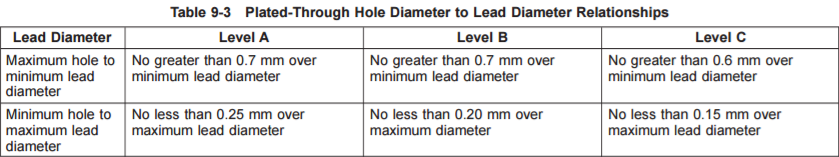

    Hi:
    For a part that has an actual diameter lead of 1.2mm.
    What size should the PTH be? How much tolerance to add?
    I was thinking 1.25mm but then would the plating impact on this?

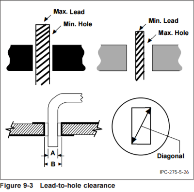

    IPC-2222 covers this.

    Those seem like huge tolerances in today's age. Most boards I've had made seem to be spot on. 0.7mm over is huge - most of the time my holes are less them 1mm and often less than 0.7mm.

    DerStrom8 could you elaborate on what Level A-C are?

    From IPC-2221:
    Simply put, Level A is highest possible quality (medical equipment, aerospace, etc) that is more difficult to produce, Level B is moderate quality (consumer products, etc) which is standard producibility, and Level C is the easiest to produce but with lower quality (hobby projects, etc).

    I guess I'll go with 1.3mm holes for 1.2mm leads. I've tried 1.5mm but mechanical integrity is a bit questionable as these are spade terminals.
