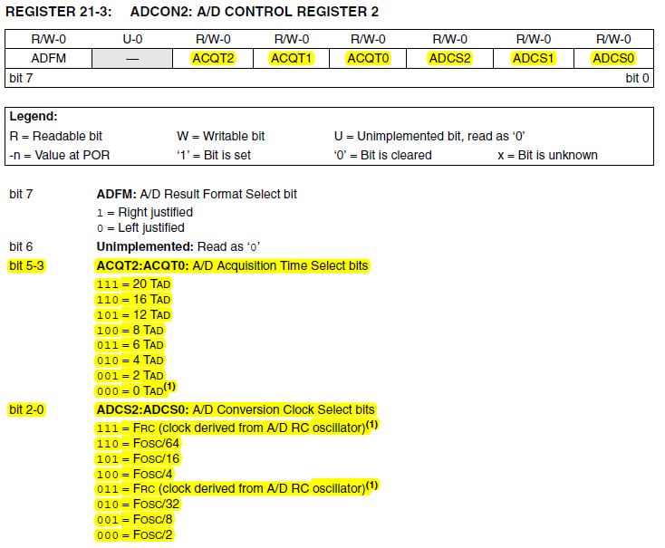

And can someone explain to me what exactly T[SUB]AD[/SUB] means and how to determine which one to use?? and how to determine the conversion clock select bit? (see attached pic)

Hi Adrian,
I have no idea why your result is shifted but I can hopefully explain what TAD and the conversion clock are.
TAD is your A/D converter clock source. If your TAD (AD Clock source) is too fast, then you will have inaccuracies in the last few bits of your conversion. If your TAD is too slow, then the internal sample-and-hold capacitor will slightly discharge before the conversion is completed, resulting in a lower reading than it should be.
So 1TAD is one cycle of the AD Clock and therefore 20TAD is 20 cycles of the AD Clock. The conversion internally takes 12 cycles (12 TAD) to complete. There are minimum TAD times for AD modules also.
You can work out your TAD based on your AD Clock source. For example a PIC32MX has a minimum TAD time of 83.3ns which is equal to a 12MHz AD Clock source.
Just a little on the acquisition time too... If your acquisition time is too short, or your input resistance too high, then the internal sample-and-hold capacitor will not have enough time to completely charge, resulting in a lower than normal reading. The acquisition time is a function of the input resistance and the internal capacitance.
HTH.

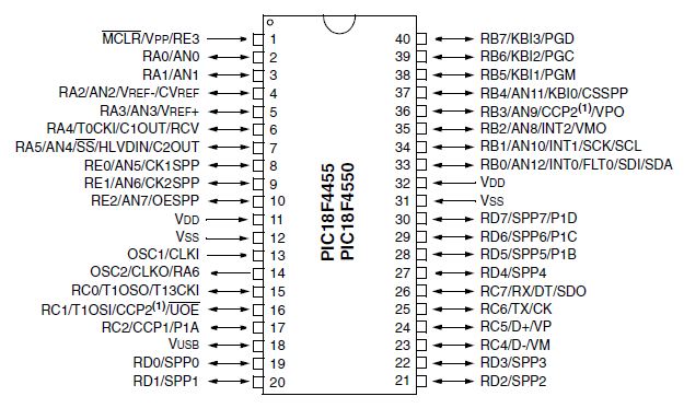

Can i set the +ve reference temperature (pin 5) to a voltage of more than 5V ?? or will i damage the PIC if i increase it more than 5V??

Hi Adrian,
Generally VDD (or AVDD) is the upper limit for Vref+. You can damage the PIC by using a higher voltage.

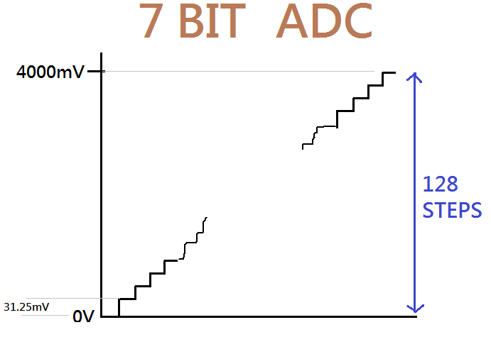

Thanks for the reply. Since i cannot increase the ref voltage above 5V, is it possible to set the ADC to 7 bits instead of 8 Bits?? The reason for this is that i want to represent 128 bits for an analog input which will vary from 0V to 4000mV (i.e. 31.25mV = 1 bit)
The diagram below may help you understand what im trying to do.
...Since i cannot increase the ref voltage above 5V, is it possible to set the ADC to 7 bits instead of 8 Bits??...
Yeh sure. Just shift your AD Result right until you have the 7 upper bits.
So for a 10-bit A/D shift right 3 times and you are left with a 7-bit result.
Dividing your 10-bit result by 8 will do the same thing (or divide your 8-bit result by 2).
