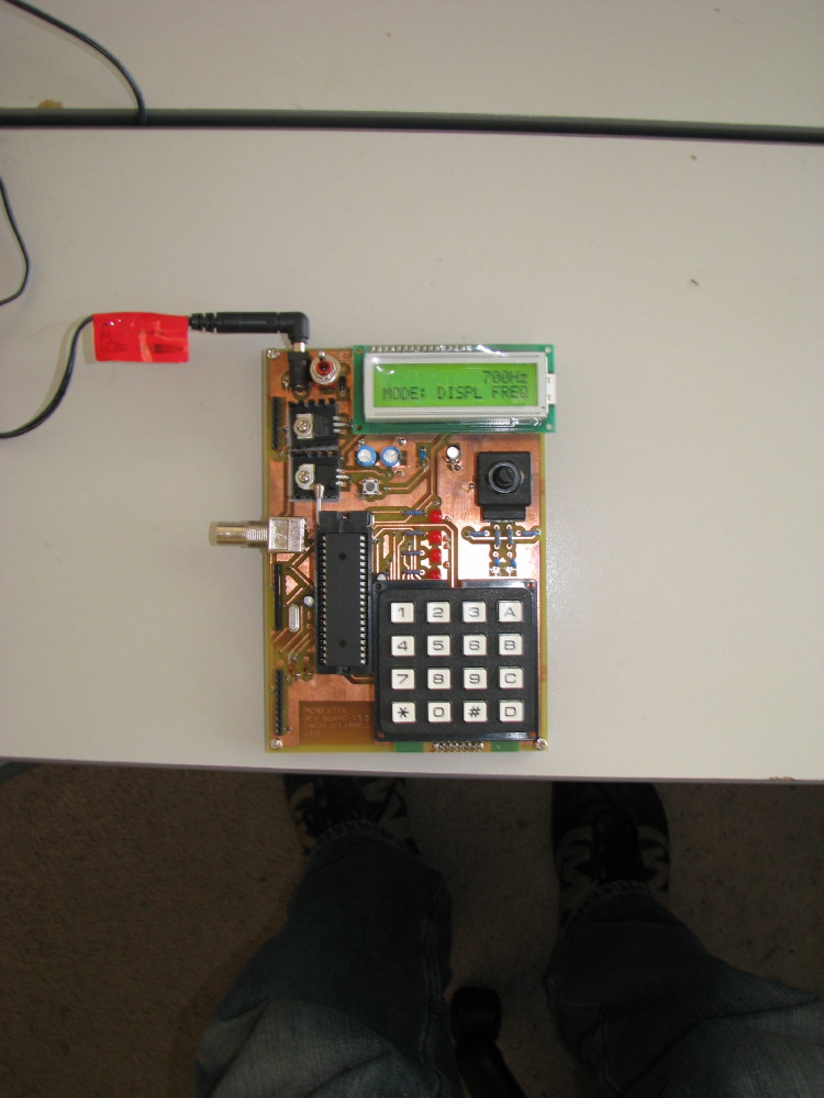

Dear All,
This is the thread I will be sticking with, with regard to this project I am working on from now on. I have included a picture of the dev board I have built and the schematic as well.
Some background. I decided to start this project as I needed a function generator for other projects and yes I could actually buy one for a bit of money and no time but I thought what was the fun in that... so my real driver was to learn something... start a challenging project and something might rub off.
There are a number of projects out there on this subject however I chose to base mine on another project which can be found here... It was very good but used two PIC chips and I thought it might be a good idea to work this from just one chip... to this end I have built a development board for which I have included a picture... Further I am including the schematic as well.
All is going fairly well but alas I find myself floundering again.... and again its to do with the interrupt routine.
Here is my current problem...

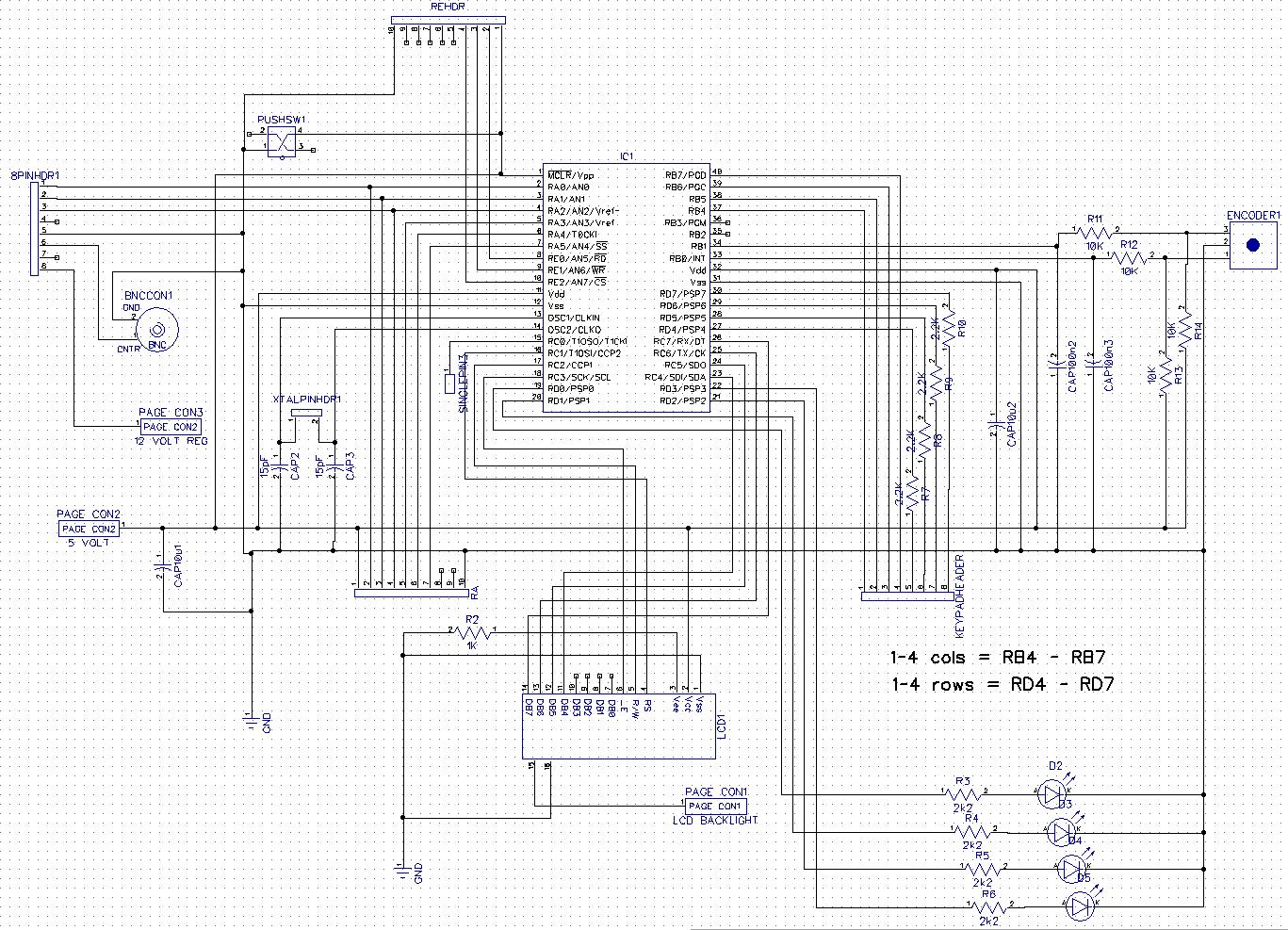

As you are aware the PORTB7-4 pins have been set as inputs, so how do you pull up these pins with your keypad.?
Measuring open circuit inputs will not give the readings you would expect, they are floating.
EDIT:
Looking at your circuit diagram It appears the PORTB inputs are floating until a key is pressed.?????
So if I wanted a system where PORTD was 5Volts and PORTB7-4 was to sit at 0 volts then I need to pull these pins down... say a 10k resister to deck? Would this give me the outcome where you press a key and send those PORTB7-4 pins high?
Just thinking about this... In my original design I have used the weak pull up option available as a software setting but it pulls up ALL PINS in PORTB. Having the encoder on PORTB1-0 and having weak pullups with the encoder's middle pin grounded might cause the interrupt to fire on the INTE... I am not sure though..
OK In the larger project above I set the INTE interrupt to 0 and it still failed to work when I made RB0/INT and RB1 to Inputs...
If the intention is to pull up the PORTB 7~4 pins when you press a key, then if you have used weak pull ups this means they are high already.
I would suggest 10K pull downs and 1K pull up via the key contacts.
If you have set the PORTB to interrupt on any change of state on PORTB , you should read the PORTB to clear a mismatch.

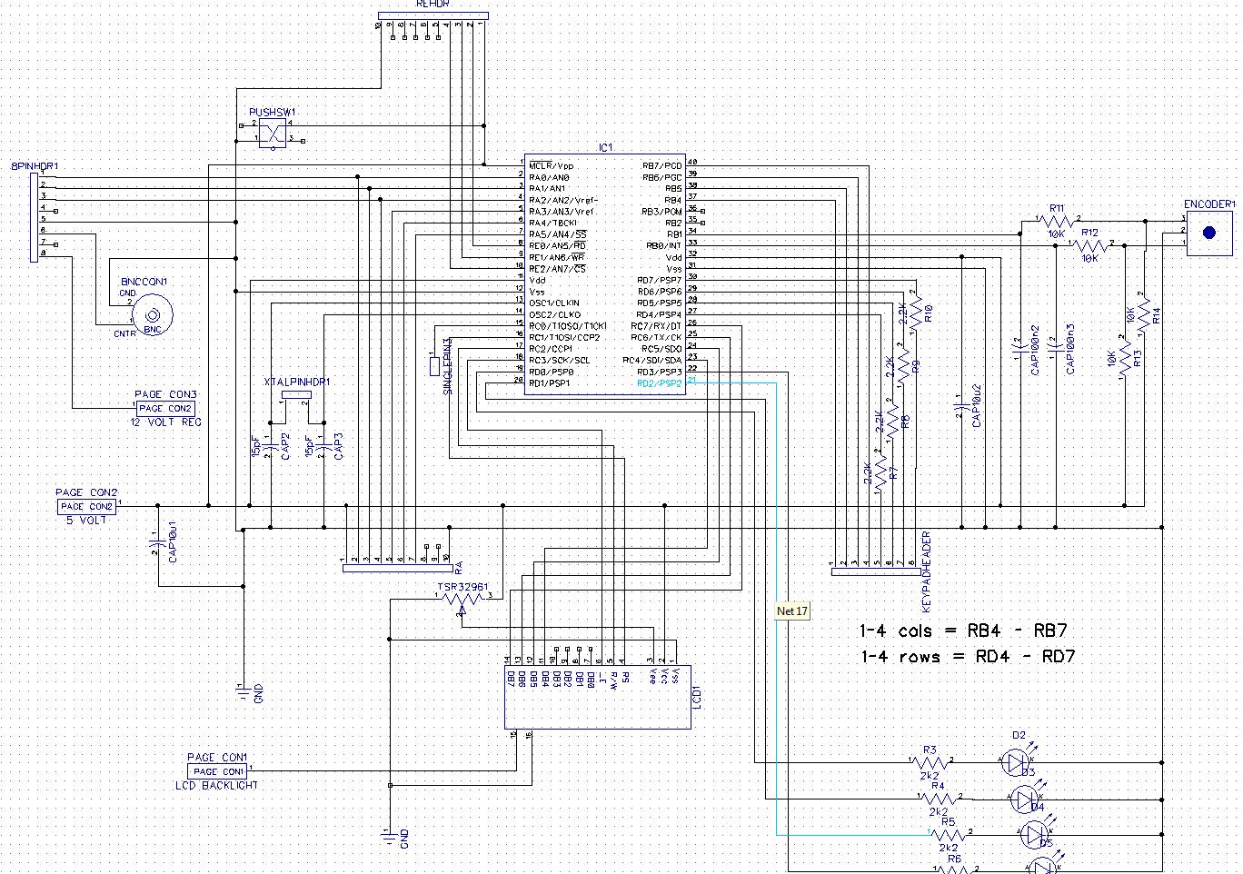

Can you post a sketch of the keypad circuit showing how its connected to the PORT's?
Hi Eric,
Below are the connections for the keypad... There is a 2.2k resistor between the keypad and RD7-4
"FROM THE DATASHEET"
Output Pin
1 COL 1
2 COL 2
3 COL 3
4 COL 4
5 ROW 1
6 ROW 2
7 ROW 3
8 ROW 4
As its connected on the board.
;    keypad
;                     rb4        rb5         rb6          rb7
;                    col 1       col 2       col 3        col 4
; rd4-------row 1 |    1    |  |   2    |  |   3    |   |   a    |
; rd4-------row 2 |    4    |  |   5    |  |   6    |   |   b    |
; rd4-------row 3 |    7    |  |   8    |  |   9    |   |   c    |
; rd4-------row 4 |    *    |  |   0    |  |   #    |   |   d    |
Here is the schematic showing the resistors being connected.
Hope this helps
Simon
