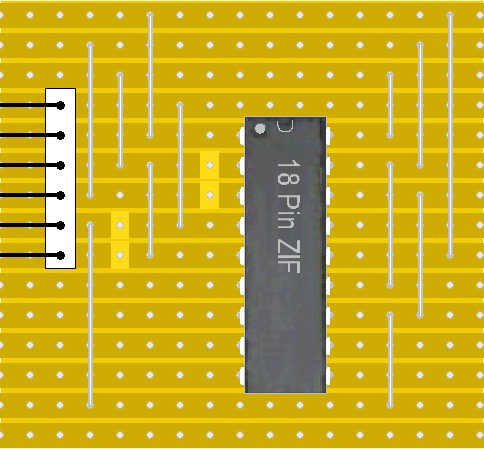

Just make yourself a plugin board for the PICKit2, with an 18 pin ZIF socket.
Like this:

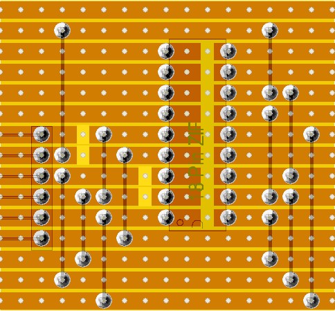

Hola Nigel,
The 6th pin (bottom ) in the connector, goes nowhere. Why is that?
Think I would add a few R's C's and numbers to Nigel's circuit
Its only a programming socket!!! I have the exact same board for over 8 years!! No Cap's or Resistors on mine..
The pin 6 is an auxiliary pin I think its used when the device is a logic analyser!!
My thought was the OP may incorporate it as ICSP !!!!!!!!!!!!!!!!!!!!!! to another circuit board, and 1-6 may help with orientation of PK2 . ( IMHO sockets should always be labelled ) And was coming from a PK2 dev board.

No need or reason, it's just a programming socket - you then transfer the chip to it's target board.
I built it because I had a fair number of identical chips to program for a project I did for someone.

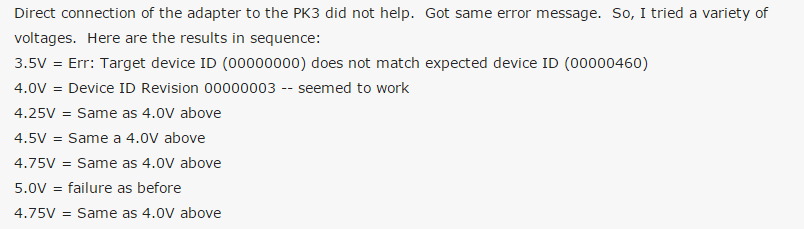

Yes, sometimes you can get by with no decoupling cap across Vcc and Vss when programming with the PK3, but there are many threads on the Microchip forums in which such caps are recommended when using that programmer. Here are just two: https://www.microchip.com/forums/m897087.aspx and m690219.aspx . In each of those cases, the author is "Ian.M." In my own experience with the 12F683 and PK3, a cap along with reducing the programmer voltage to slightly less than 5.0 V cured the problem (target powered by programmer mode). The power supply on the PK3 is not very robust. If you put a scope on it and watch Vcc, you can see it sag significantly when programming.
John

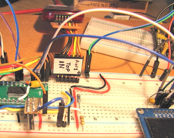

Got two of each 2&3 , 3 every time , although the tools on PK2 very useful. ( never understood the lights on 3 o_O ) my tip would be keep the connections short ( and keyed I use a 7 pin connector with a key plug in pin 7 )

Nigel,
I am referring to just a target board and a ZIF socket in which the PK3 provides power to the target. Power up a 12F683 and put a scope on the Vcc pin. I pulled my hair out over that a couple of years ago. System worked fine, then 6 months later it didn't work. Solution was to add a decoupling capacitor and reduce the voltage to 4.85 V or so. The reduction in voltage was a suggestion off the Microchip forum, but I could't find that post this morning. The search function for my threads didn't go back far enough.
John
EDIT: I found my data from that January 2013 problem:
Again, that was just the 12F683 in a ZIF on an adapter board to PK3. Added the bypass also as recommended by several people. At that point, I started programming with the PK3 at 4.75 to 4.85 V (sorry for the typo above, I corrected 5.85 to 4.85 as that is what was intended) and have had no further problems.
John
